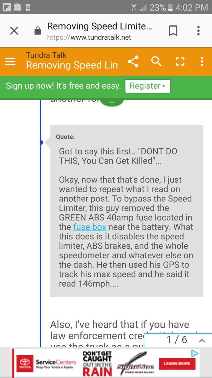

    Wonder if pulling the abs fuses in our trucks will disable the speed limiter like the tundra. Would be useful on a dyno

    Purple wire, with a switch, in the Tacoma. More simply, unplug the speedo, at the trans. Most complicated: get a standalone.
    His disclaimer is garbage. You can get killed at any speed, any where, with or with out a vehicle. Chance, luck, fate, or motivation set the pace for winning that race. Ha.

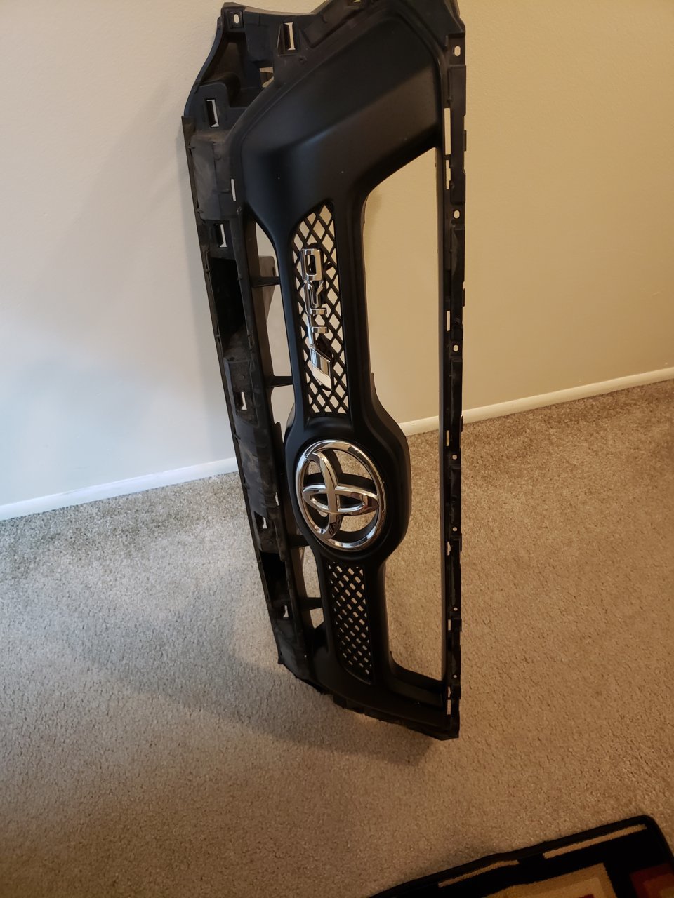

    I trimmed off the lower vertical supports on the factory grille for mine to fit. I didnt use the bracket it came with either. I used a bracket that I had on a previous truck. My current trd pro grille didnt need any trimming.15325801206441916379417938451333.jpg

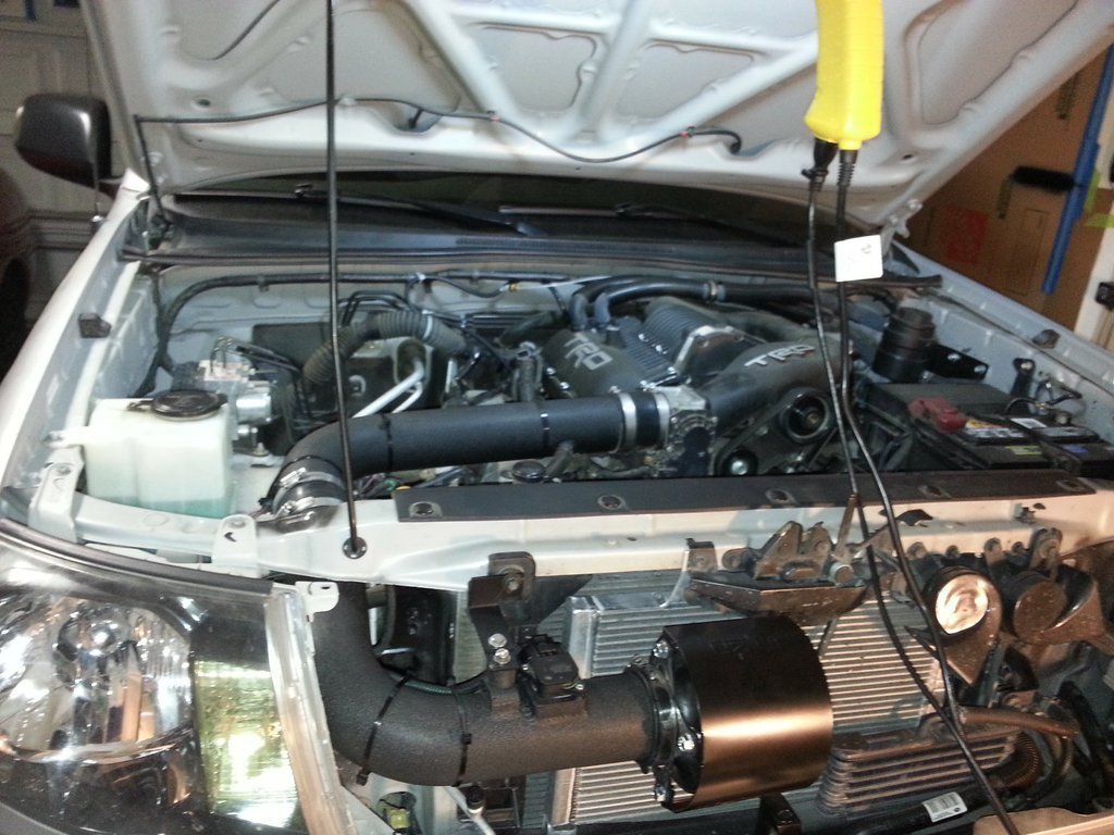

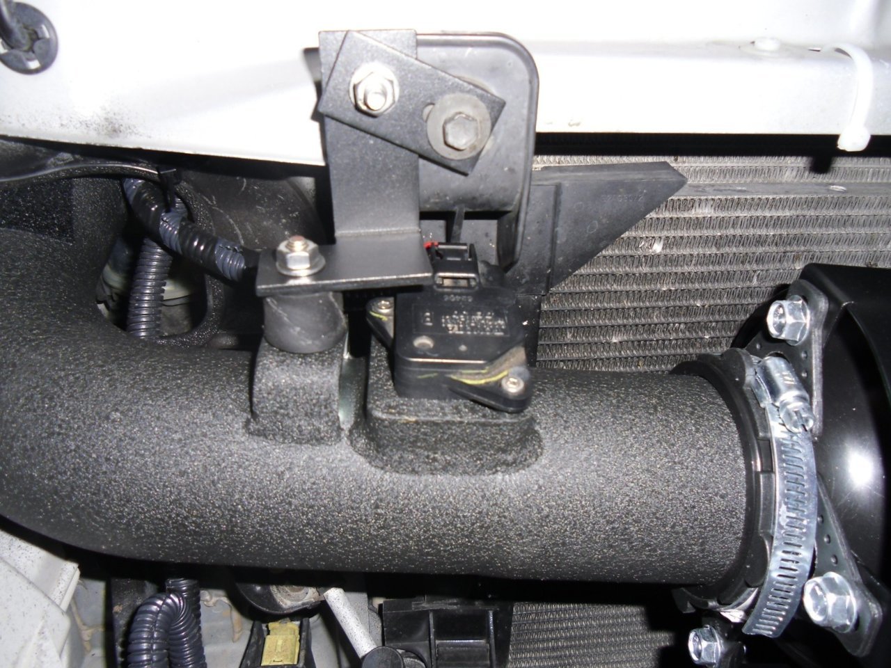

    Minor sheet metal cutting... dremel, body saw, simple.
    I have a grillcraft.... all i did was flip the urd brackets.
    Hell, maybe i removed 1 even
    N/a setup (normal)
    Boost setup.... notice the bolt and bracket placement... it kicks the intake out a little more
