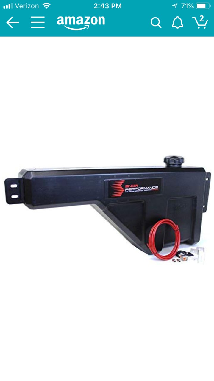

    Wondering if I can mount the pump and tank in the bed and run the wiring and hose up. Snow has a nice in bed tank.

    I dont see why not.

    Yes you can. I bet they will reccomend a solenoid to prevent backflow and braided lines. It would look nice. Just remember the pump must be at or below the tank placement. Their recommended idea.

    Would look nice in the front of the bed. Make some mounts to attach to the rails.
