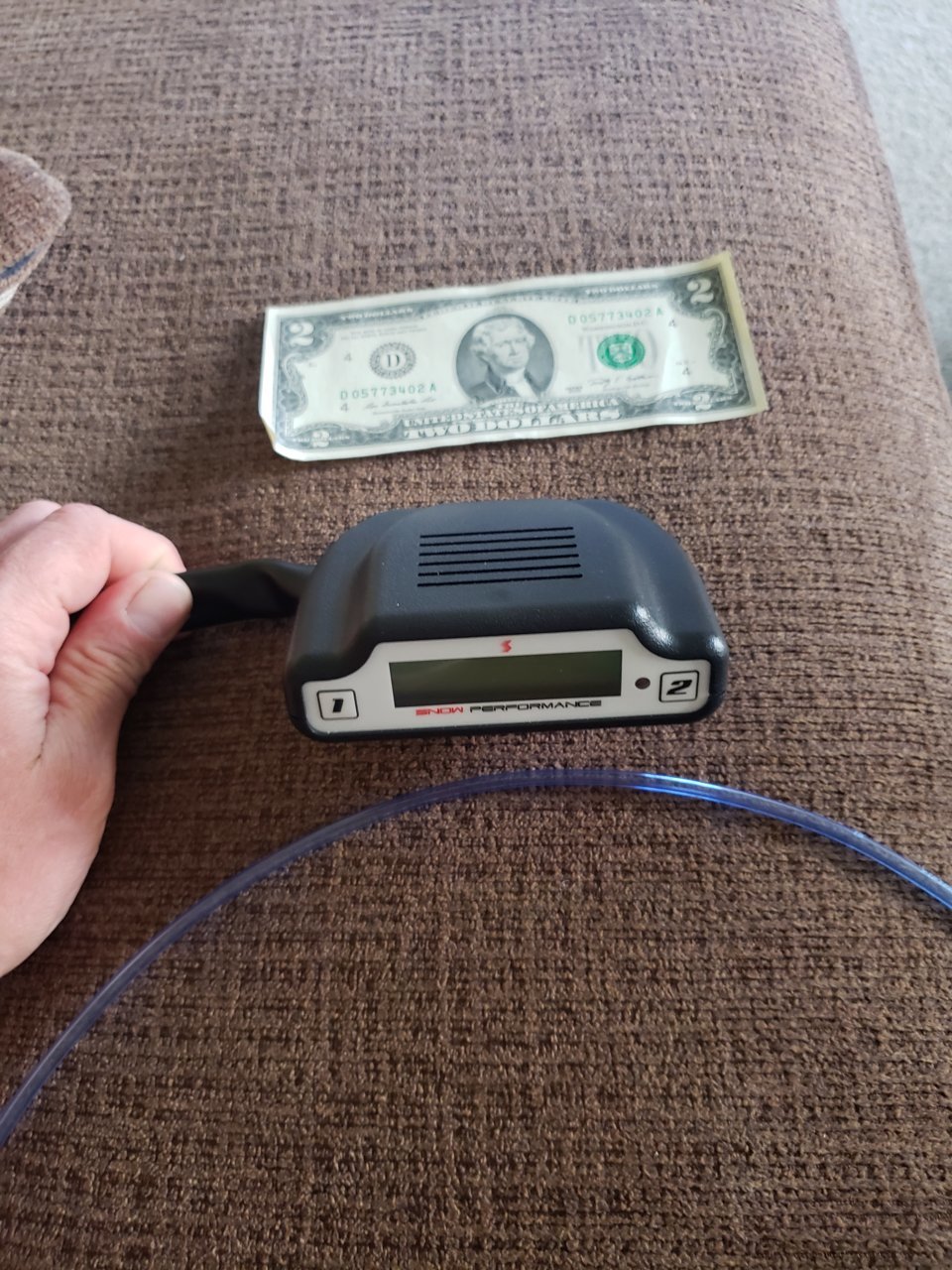

    I will post new pics in a couple hours. Injector pulse is tapped off via t-taps on passenger side injector. Now I can see a percentage read of load as I'm driving. Example. At 60mph I'm at about 9% load.

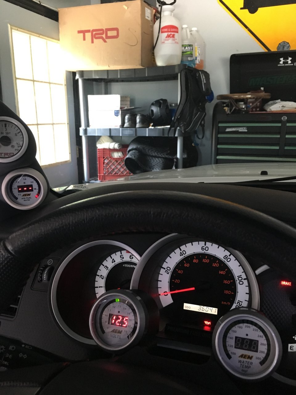

    So I was gonna wait to share this but now that the factory temp gauge is up as a subject matter I might as well post it.
    I added a couple more guages to my setup. I have not yet installed my awesome radiator but I’ve ran the wires and just need to tap in the sensor to the radiator once installed and plug in the fuse tap for power to the water temp gauge.
    So here you go....

    I thought of a scan gauge too but I wanted to add a couple more gauges and like the look.
