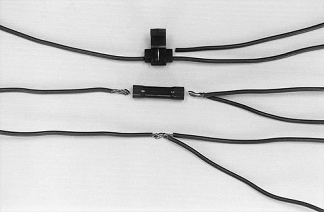

    I don’t like fuse taps. I tap into the existing wiring.
    Find the wire you want to connect to. Remove a section of the insulation. Wrap the wire you want to tap into it around the existing wire. Solder the connection. Insulate it with 3M Super 33+. Wrap all your aftermarket wires in TESA tape so nothing rattles. Use zip ties to secure your wiring to factory harnesses. Take care in routing aftermarket wiring to avoid contact with moving parts such as seats, pedals, levers, shifters and steering columns.
    Don’t be scared of cutting into wires. If you do it right, the car won’t burn down. It’s all hidden behind the dash, so resale value isn’t affected. A good solder and tape job will last forever.

  6. Aug 5, 2018 at 11:31 AM
    #6066
    loginfailed
    loginfailed Well-Known Member
    Aug 29, 2016
    #195923
    5,156
    Dwayne
    Houston, TX
    2014 DCSB 4WD
    Bottom example.
