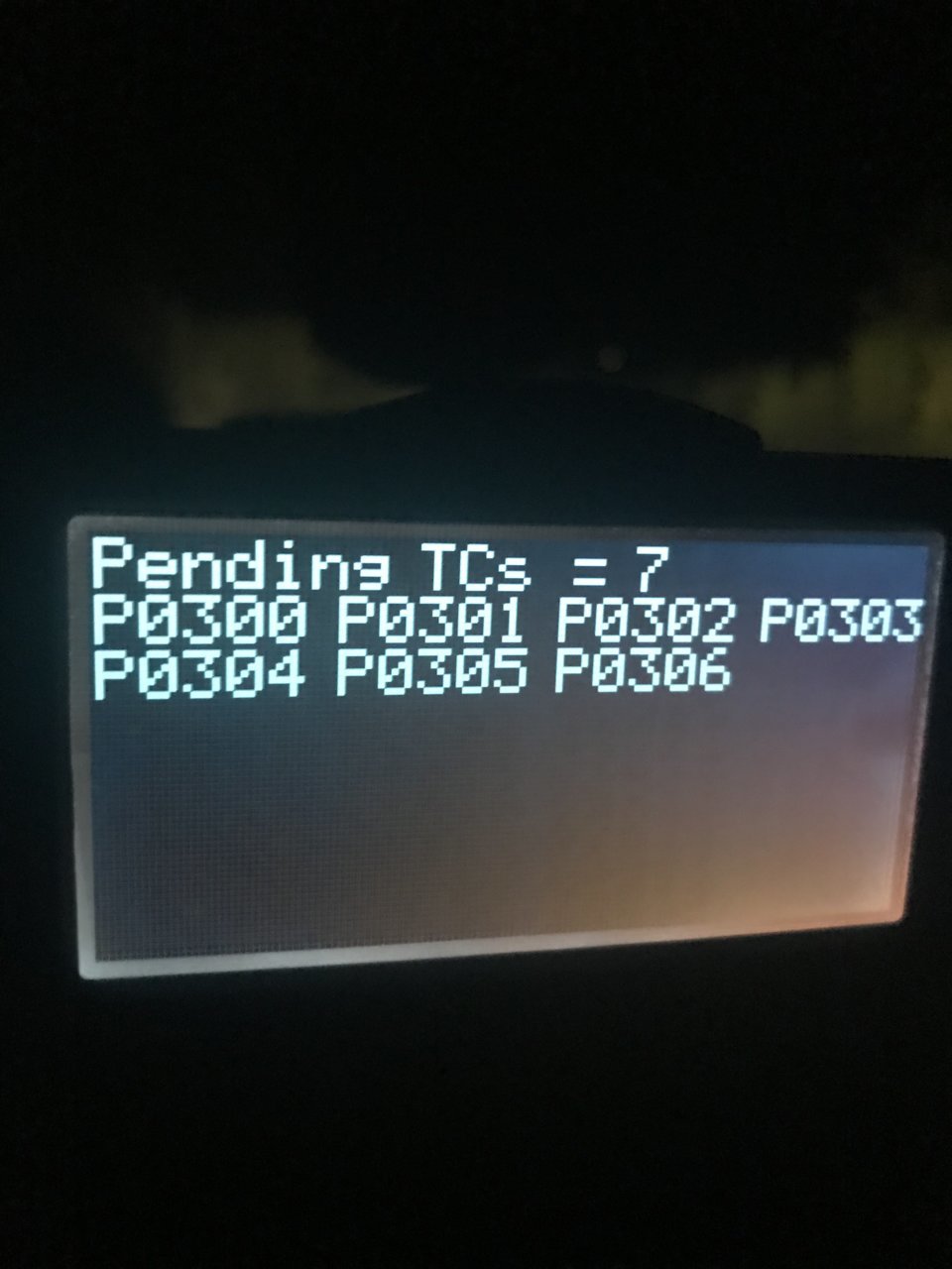

    Okay theres some weird shit going on..
    Swapped the fj coil in, same p0353 code.
    Swapped back to the tacoma coil, but this time moved the passenger rear to the front and the front to the rear. Now its throwing multiple codes. P0300 (multiple misfires), p0305 (cyl 5 misfire), p0306 (cyl 6 misfire), and p0356 (Ignition Coil F Primary/Secondary Circuit Malfunction, which i believe is relating to the coil pack on the rear driver side under the blower).
    Im starting to think i may have a UCon issue with the board itself..

    Keep track of where you are moving your coil packs. It could be a wiring harness issue because you are manipulating the harness with each change.
    Try pulling the negative terminal off battery for 5 mins to reset the ecu and icon to allow them to resync.

    Sure. Then if it throws codes try moving the wiring harness around without disconnecting the leads from the packs. You are doing good, wr just need to keep isolating the prob.
    Is it running like doo doo or running fine?

    Runs alright until i give it a little gas when im on the road, then it starts running like shit.
    Will go do this now and see what happens

    Reset the ecu, throwing even more codes now, all misfires:D
    Tried moving around the wiring w/o disconnecting the coils, same thing happened
