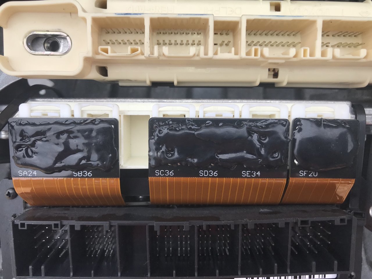

    Misfires on all 6 cylinders can be a vacuum leak. Check all hoses and make sure one didn’t come off or break while doing all the coil swapping.

    Checked all hoses and everything looks like it should. URD is having me ship them back my UCon so that they can test it, only problem now, is that half the clips that hold the UCon connections into the stock ecu are broken off, making it impossible to separate the two. This has turned into a real pain in the ass

    How does that make it impossible to separate the two? All I see are broken retaining clips to the connectors.

    Full-time AWD & BorgWarner EFR 6258
    Hard to get anything small enough in there to get the clips to release without damaging the ucon or the stock ecu..

    Would something like eyeglass screwdriver work? From a repair kit?
    Toothpick?
    May have to get one of those. Problem is there is very little clearance between the black portion of the ucon connections and the top of the stock ecu plugs. I tried a very thin pocket knife and it felt like it wanted to break. Whatever it is, has to be very thin

    2015 DCLB
    One of my clips broke .. was able to get a flat head between the clip/ecu and wiggle it loose.
    Managed to get the ecu and the ucon separated.. mailed it back, hoping that is what was causing the issues..:fingerscrossed:
