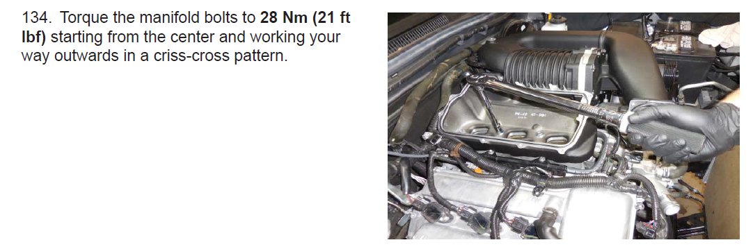

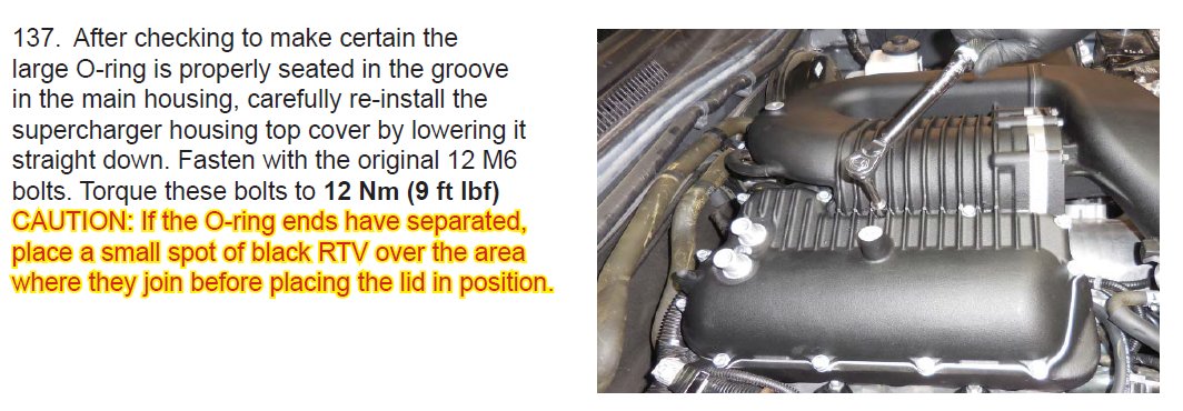

    Thanks. I didn't do my ac install so I have no documentation that would have any torque specs. Dealer installed at 17 miles lol. Gonna try to grab a second wobbly and see if that works. If not I'm pulling the sc. shooting for tomorrow afternoon. If you or anyone can find important torque specs, please post up.
    Thanks
  16. Aug 22, 2018 at 9:22 PM
    #6216
    oni06
    oni06 Well-Known Member
    Jul 1, 2016
    #191029
    3,261
  17. Aug 22, 2018 at 9:23 PM
    #6217
    oni06
    Jul 1, 2016
    #191029
    3,261
  18. Aug 22, 2018 at 9:25 PM
    #6218
    snowsk8air2
    snowsk8air2 how hard can it be?
    Sep 16, 2011
    #63607
    10,488
    Flagstaff, AZ
    Supercharged TX Pro
    2011 S/C and basic mods
    Perfect and thanks.
