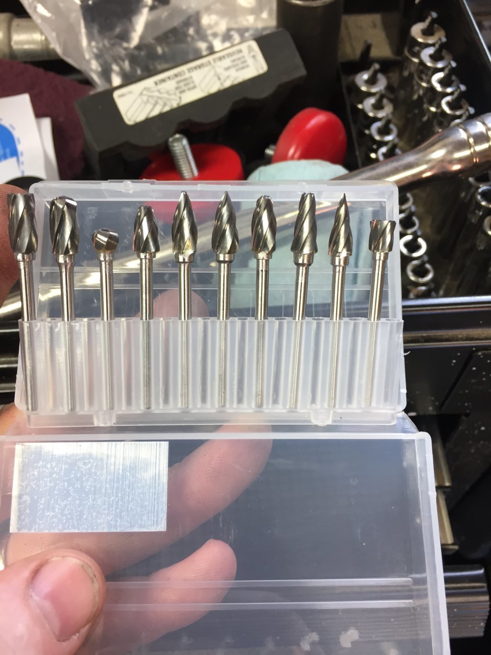

    Mmmmmmm! Fresh meat!!!
    Similar dremel accessories. Mine are cross cut though.
    You saw my pics of the potted inlet maniflod in my thread correct? I tagged you on it.15352500733789146665960638783742.jpg

    Ya I saw your pics. Once salt hits the roads the x will be up for the winter and I’ll start taking stuff apart and removing aluminum. Weight savings lol.

    Once again it lives, I performed the tensioner shave stop mod as discovered by @Roostfactor while I had it off. New and improved AND I gained .5 lbs of boost in stepping down belt sizes. :D

    Those are burr bits specifically for a Dremel tool?

    I was wondering that too.

    they were $20 so i figured i would give them a shot and see how they go. they are for a dremel

    Hmm. Wonder how much Roost's were. I have burr bits for my drill. Made in the USA. Not cheap, but worth it for the quality and performance.

    Cheap bits arent worth a sh*[

    I think mine were $20 on Amazon as well. Yes for a dremel. They work great!

    Pull off tensioner, grind down the stop (the shiny part is how much I ground off). This allows you more adjustment to get the belt on.

    The mod Roost showed you helps A BUNCH.
