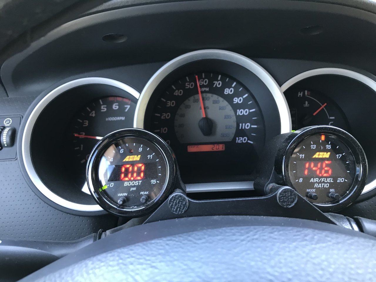

    Overdue pic @White lightning boosted
    RPM about 1900 w/ 60 mph (speedo is off 10%, so that’s why it’s 56ish). That’s with 4.56 Nitro gears on 35’s
