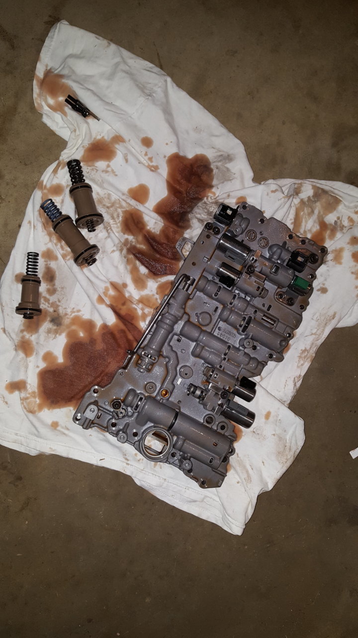

    Nice. What are they changing?

    I'm not entirely sure as they don't like to give out specific details, but from what I understand, they mod the VB similar to the ratiotek kit with bigger springs and wider orifices, and they also replace several aluminum components with steel where the factory VB has some steel on aluminum friction points that cause premature wear in the aluminum. Exactly what components and where, I'm not sure, so some faith is required to believe they're doing what they're saying. The reviews are good though.
    Their selling point is that you're paying for increased longevity above a kit like the ratiotek because they are upgrading the quality of certain components in addition to the shift kit.

    How long did it take you to get it out?

    Once you drain the pan, it should only take about 30 minutes to get it out if you have the stock y-pipe. It's really pretty simple to remove.
    If you have the URD y-pipe though, it will take longer because it crosses right below the pan. I had to disconnect the URD y-pipe from the header flanges to get the y-pipe to drop enough to allow the pan to slide out. That took another 30 minutes, so about an hour total for me to get it out.

    Not bad at all. Be sure to update us on the turn around time. I’d really like to have this done soon as well.

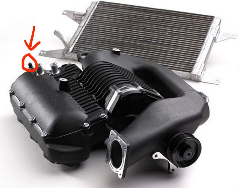

    For you folks with the TRD supercharger on a 4.0..... Where do you tap into for a vac/boost source?
