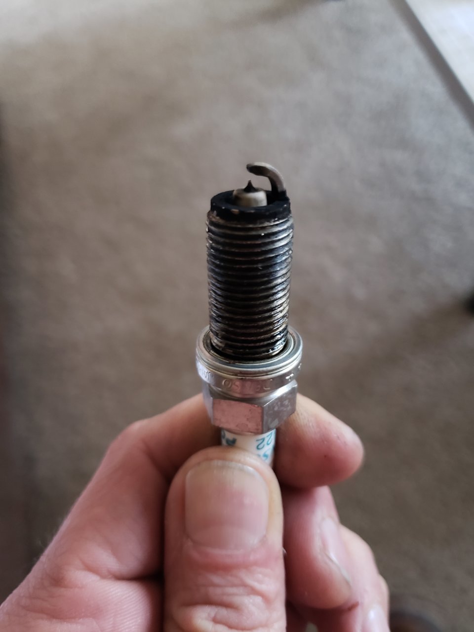

    2.8 pulley, full exhaust, 93 ovtune, dual stage meth. I realize 22's would have been better but I bought these months ago. I have a 2.6 pulley waiting to go on. Just need a hand with that.

    Mm... yeah.. 22's probably would had gotten you not only better fuel economy because you would be able to get a hotter burn, but the plugs would had been able to self clean better.. of course once you get the 2.6 on you should be in a better position because of the meth, of course the 22's still probably would had been better in either case. I'm actually really happy with my heat range 6/ 22 equal coppers I'm now running. I have yet to pull a plug to see what it looks like but I'm anxious to see what it does look like now that I've put over 1000 miles without a doubt on them.
    I'll pull a plug tomorrow and inspect it.

    That's what I pulled out. 15k miles passenger side rear

    Whew! Those have seen better days for sure! Those were 22's pre or post tune?

    That was one of the better ones. They have had 4 months with tune.

    Whoa. I'm starting to wonder if it's even worth it to run iridium's if that's the case because they are so expensive and it appears that even with a tune they don't seem to hold up water after 30K miles. I definitely wouldn't keep them in 100K for sure.

    Go with 22's run them an oil change and we could compare ours and learn.
