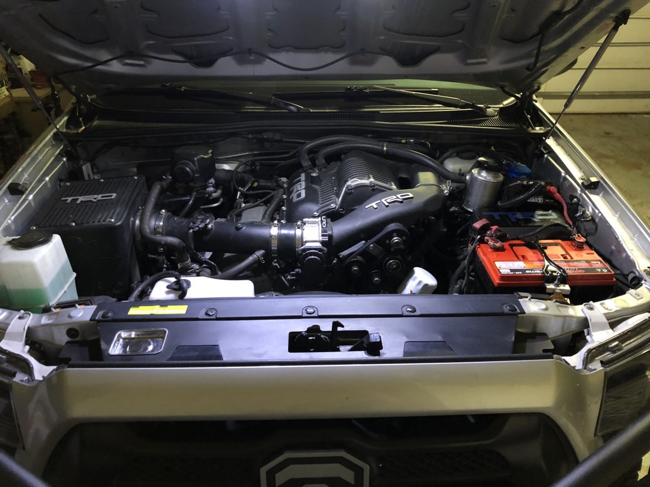

    Headers, hi-flow cats, and smaller pulley are awesome. It’s all running now. AFR’s seem spot on at 11.2 WOT with TRD tune. Still waiting on my Australian valve body upgrade.

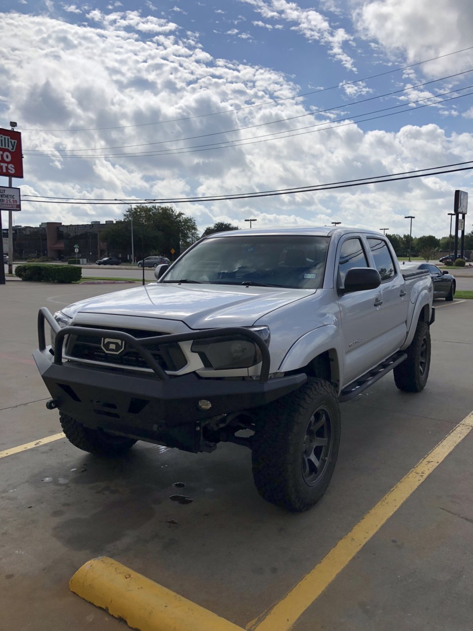

    Took so long because there was some other work going on. Now it looks pissed off.

    Looking great!

    Do you have a build thread? I really like how clean everything looks under the hood. Are you running a 2.6 with the TRD tune?

    Yes 2.6”. No build thread. I have put all the mods in my information so I can remember them.

    Looking sharp!

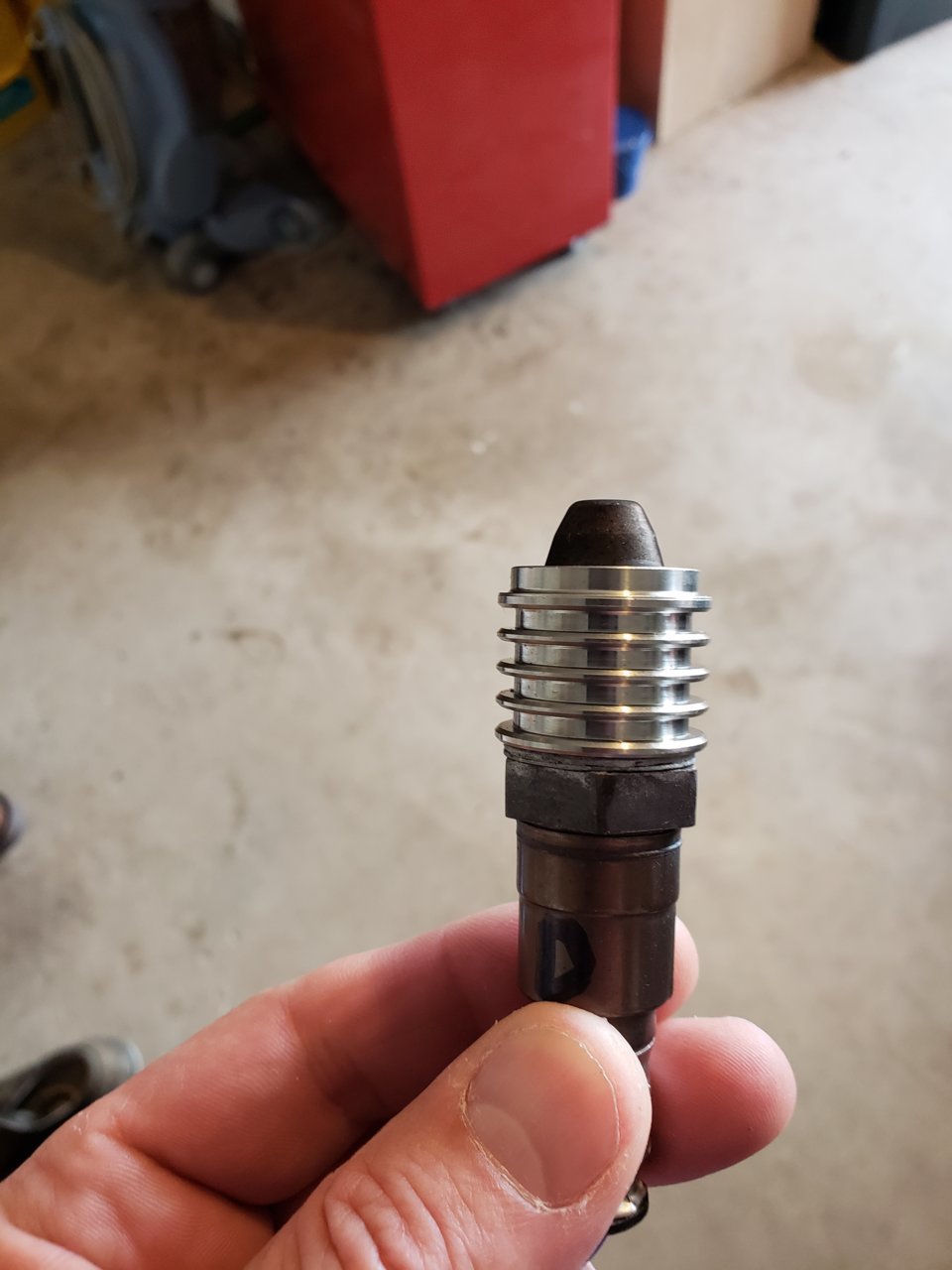

    This is a factory wideband sensor in one of my finned o2 sensor bungs. The bottom part is about an 8th of an inch and gets welded to the 7/8" hole drilled into the pipe.

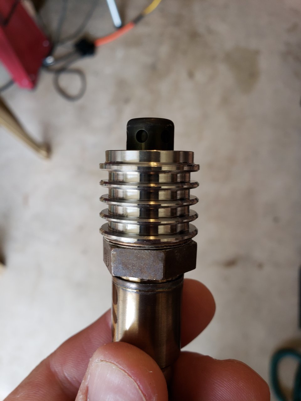

    This is a NGK wideband sensor.

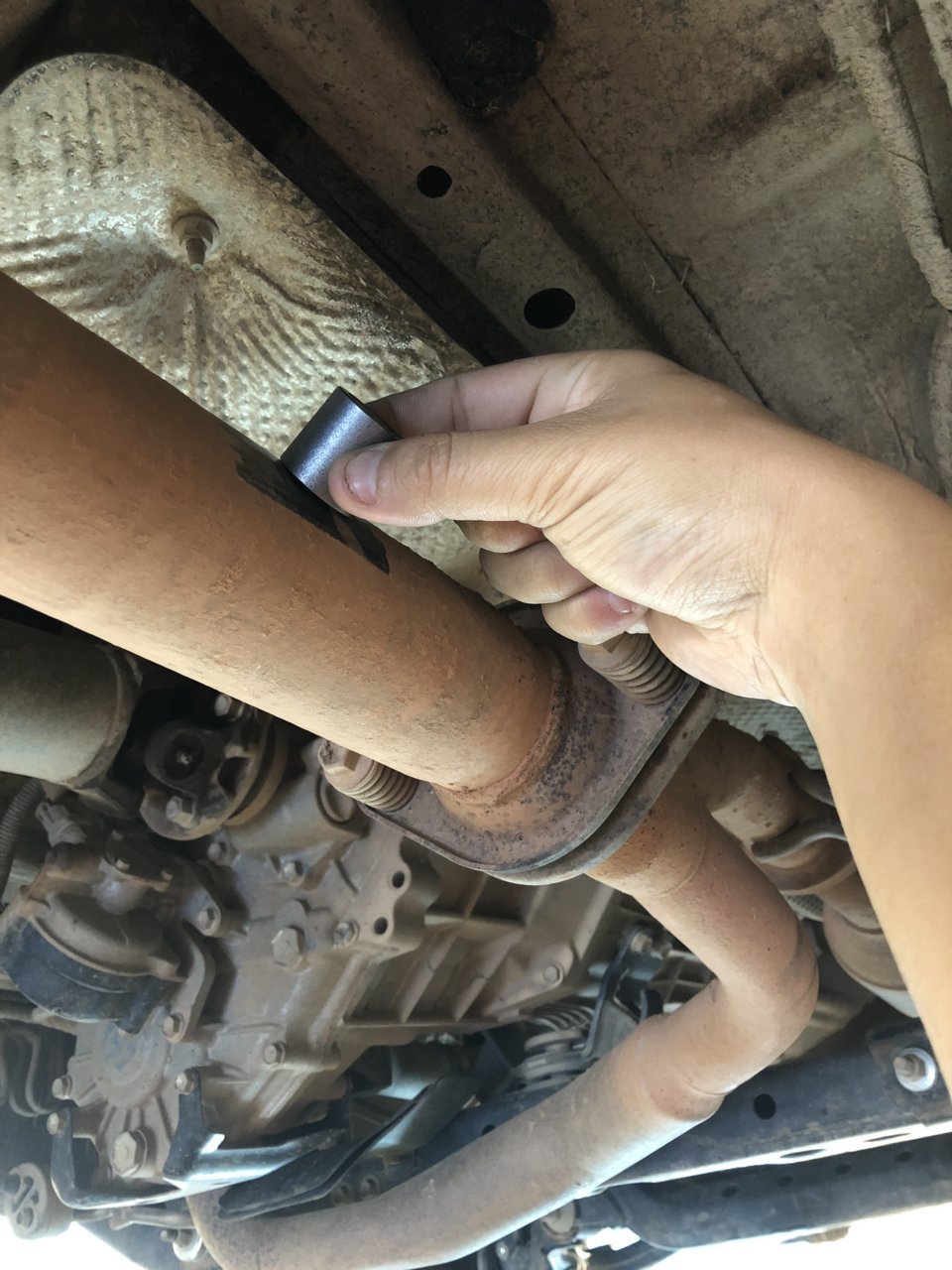

    How it would sit in the exhaust stream.
