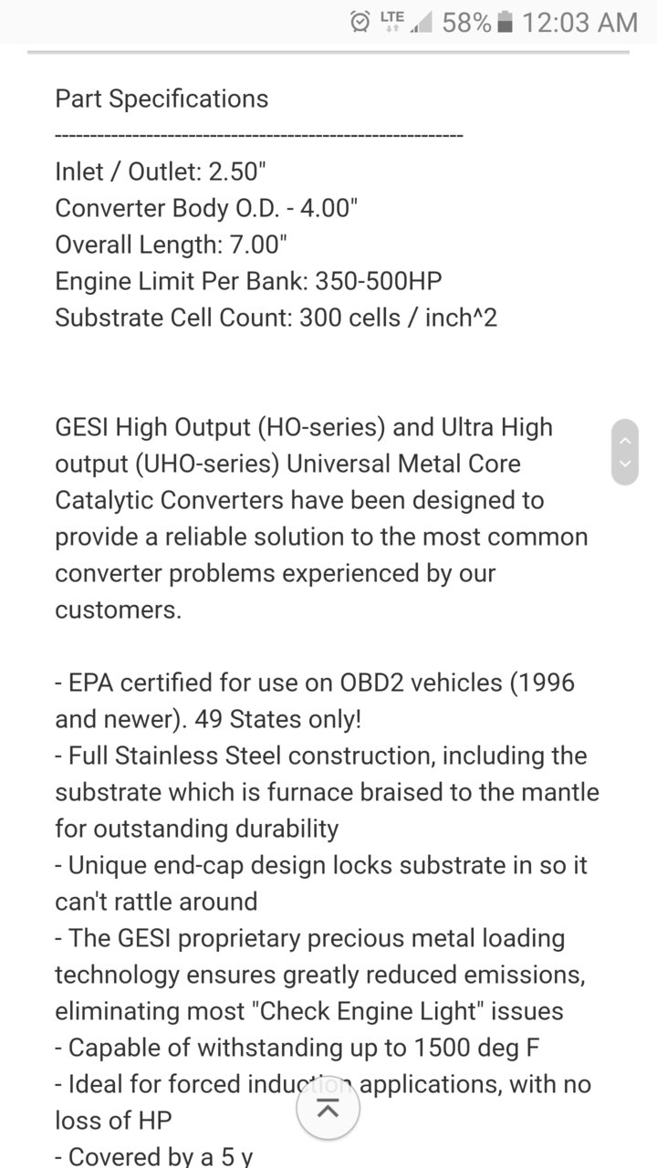

    Those are probably a metal substrate vs the stock ceramic.
    The Magnaflows I have on mine and have hooked up a few others will is a 200 cell count metal spun substrate cat. 200-400 cell count is common and the lower the number the better the flow. It has proven to be an exceptional piece for its price (about $75
    Part # is 59959 for the 3" and 59956 for the 2 1/2".

    You are correct, the GESIs are metal core 300 cell. Screenshot_20181011-000318.jpg

    The Magnaflows are definitely a better value
