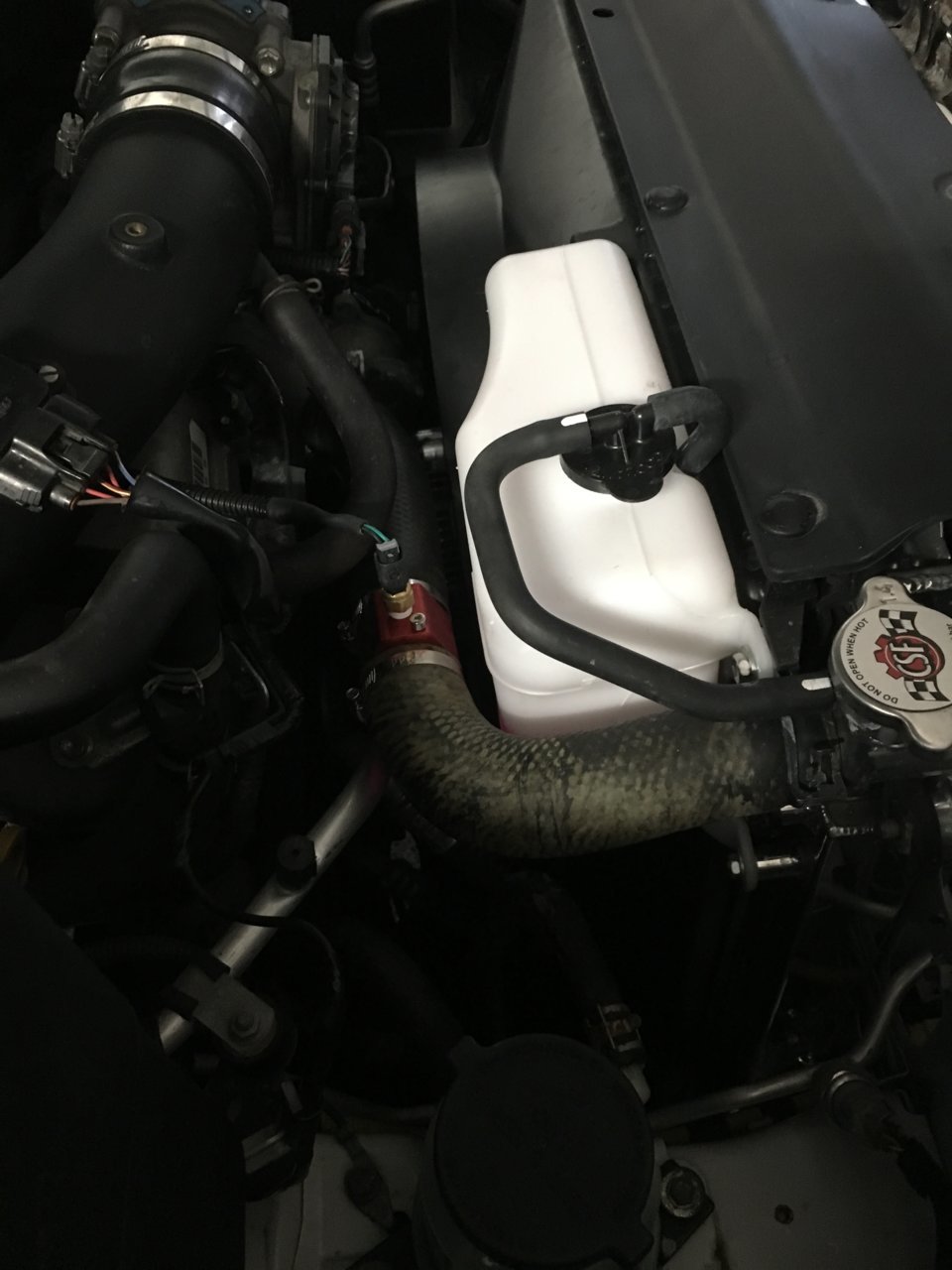

    Anyone no off hand what the size hose for the supercharger coolant?

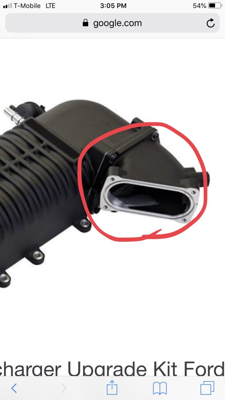

    If we cut it... That shape is better fit being an oval. Then more circular for air intake

    That’s a good question. But your taking out distance and about 180 degrees of turns for the air go through to hit the inner cooler. I would think much better throttle response and peak boost at much lower rpm.

    Unknown at this time.
    Improvement would be throttle response due to tb being closer to the sc rotors and top end because of reduced sc induced vacuum in the intake.

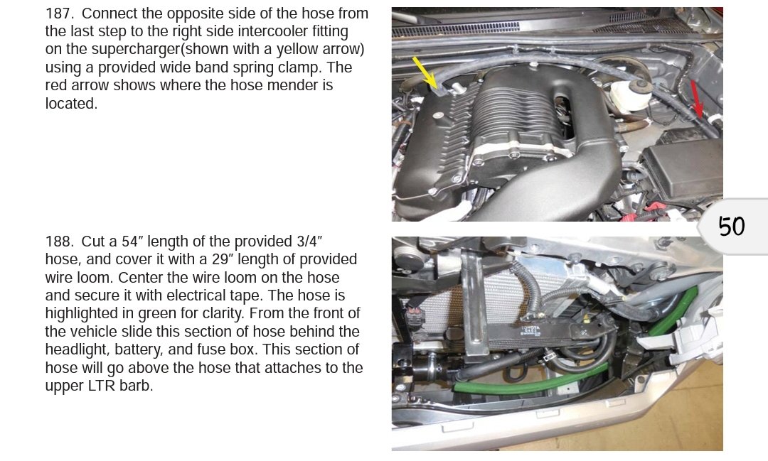

    I wanted to say 3/4 Id
    And this kinda back's that up
    Screenshot_20181012-170610_Amazon Shopping.jpg Screenshot_20181012-170600_Amazon Shopping.jpg

    Fwiw read step 188
