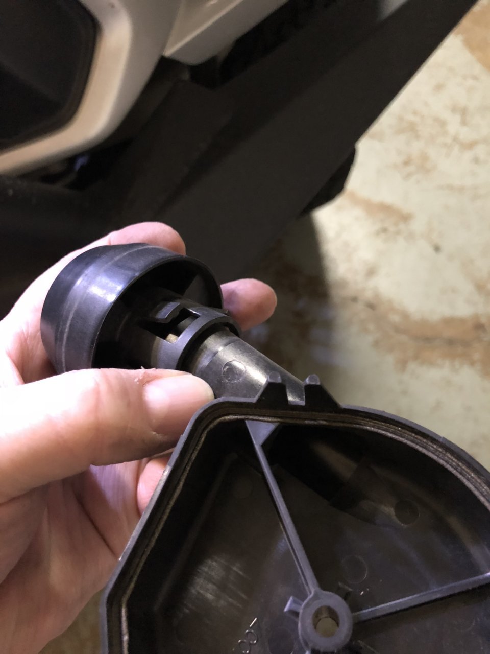

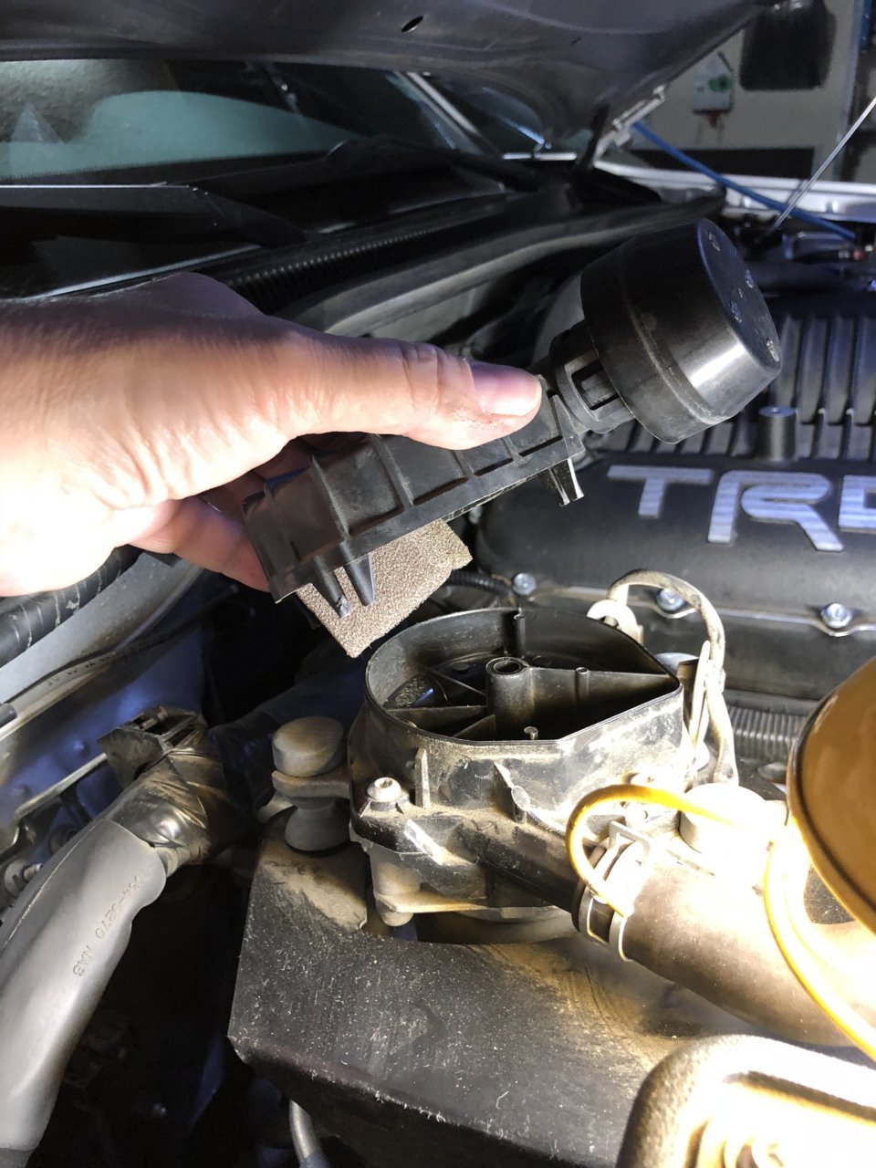

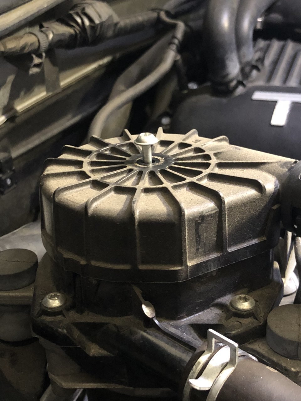

    Can one of you guys point me to a write up on the uni filter mod done correctly? I have the cover off of the pump and I don’t want to break this $1400 part. I keep searching here and I seem to just find people doing it wrong.

    How can it be done wrong?

    I figured it out. People reported breaking things. My filter cover was a bit tight, but I think that was the seal. If you’re like me and this is news to you, here are the steps to the uni filter mod.

    Gotcha. Just did this 2 days ago. 35k on the truck and the stock filter was still in great shape when i opened it upbut I swapped it anyway.
