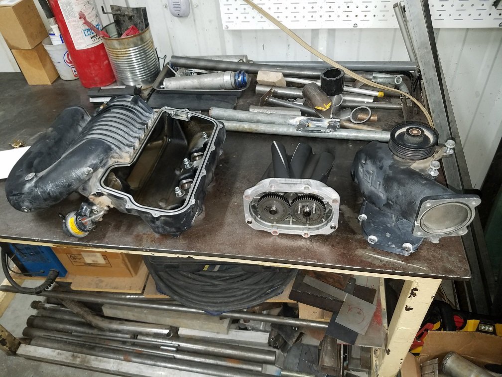

    I'm hoping the group buy closes soon. The supercharger is disassembled for maintenance and to add colder plugs. Going to pull the stock pulley off tonight to see if I can get the seal out and locate a new one. I measured the oil that came out and it was a little shy of 4 ounces. I swear I had read somewhere that it takes 6 ounces, can anyone verify this?
    Edit: I really really need to install a catch can, lots of blow-by in there.

    The fill spec is just until it starts coming out again I believe.

    I changed the oil ones, I tried several times and methods suck all of the old oil, but I could not get a full 4oz out. I had also supposed that I need to suck/fill 6oz.
