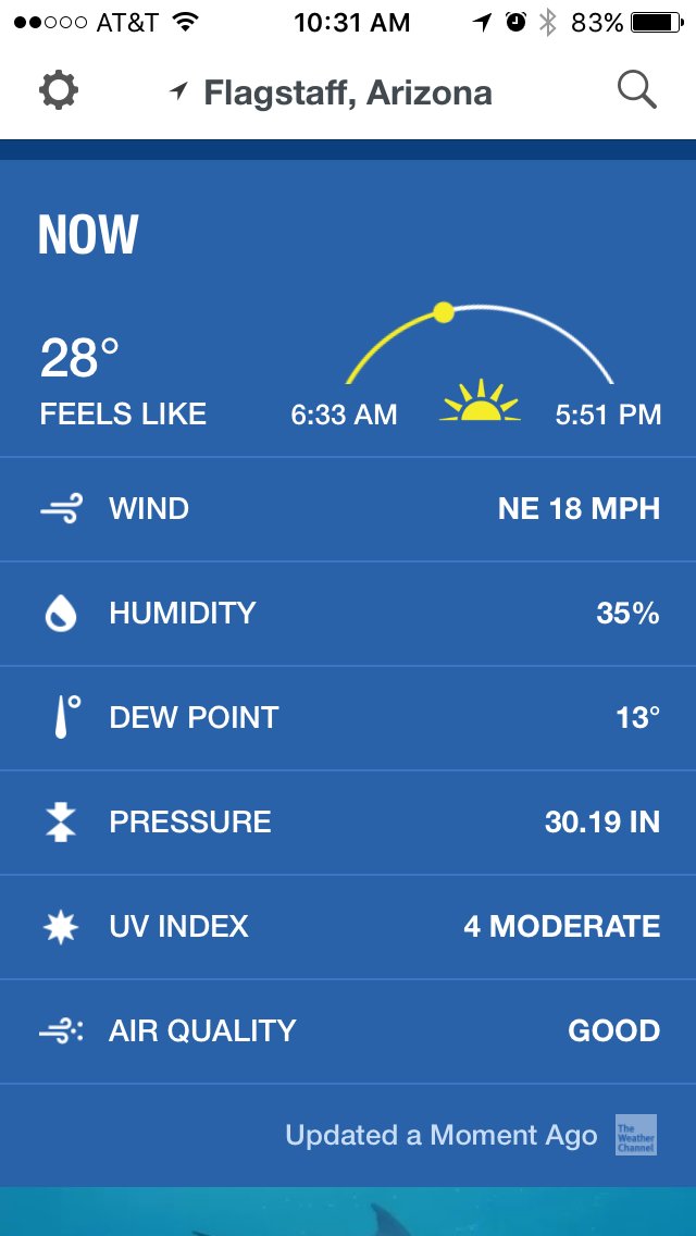

    Pshhhh if only I didn't have this elevation thing robbing all the powerIMG_3077.jpg

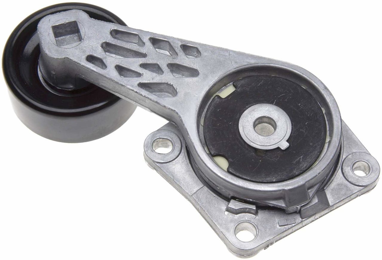

    https://www.amazon.com/ACDelco-3827...39631179&sr=8-3&keywords=belt+tensioner+38274
    A google search for the part # 38274-04-A01 doesn't bring up much, but there are a few 38724s on Amazon that look to be the same as the magnuson. I'm guessing their supplier is Gates or ACDelco.

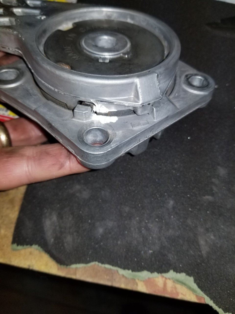

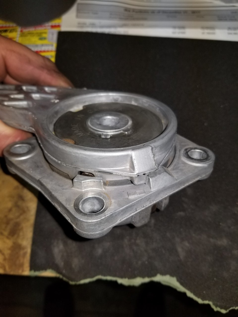

    I'm going to go with Gates. The more I look at it the more it looks like a part that is produced by Gates. It's not a bad unit by no means, it just needs some fine tuning to make it stronger to be able to handle higher tension shorter belts produce.
    Maybe it is the stop which it is striking which causes it to break because of less give the belt has which causes the tensioner to hang back closer to the stop than it normally does. The shave stop mod makes me glad I did it because I now feel more confident about it withstanding the test of time even more.
