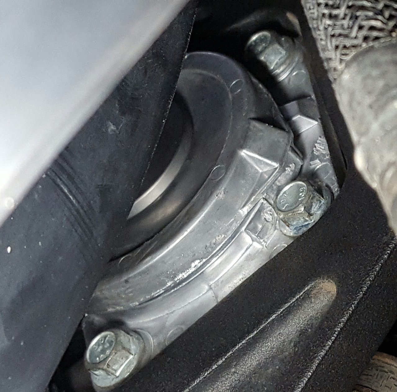

    Here's how my new tensioner sits with 69.5 in belt and 2.5 pulley. I trimmed the max stop (the lower one near middle bolt) but as you an see it sits closer to max then the minimum tension stop. This is also after I adjusted the pulley wrap mod nearly all the way out.

    interesting. that throttle body and URD Y is really the only difference. factory intake or aftermarket?
    I have the URD headers and a custom "meh" Y-pipe.
    I'm really starting to think it (Y-Pipe) just needs to be opened up to let it breath more. :notsure:

    Basically a fault line in the casting process. If others were breaking along that line as well, not just the location, the problem is with the process. Not just an inherently weak point.

    I was thinking there could be a fault in the process as well seeing that the break happens every time in the SAME exact spot. It explains a lot actually, and it is too much of a coincidence.
