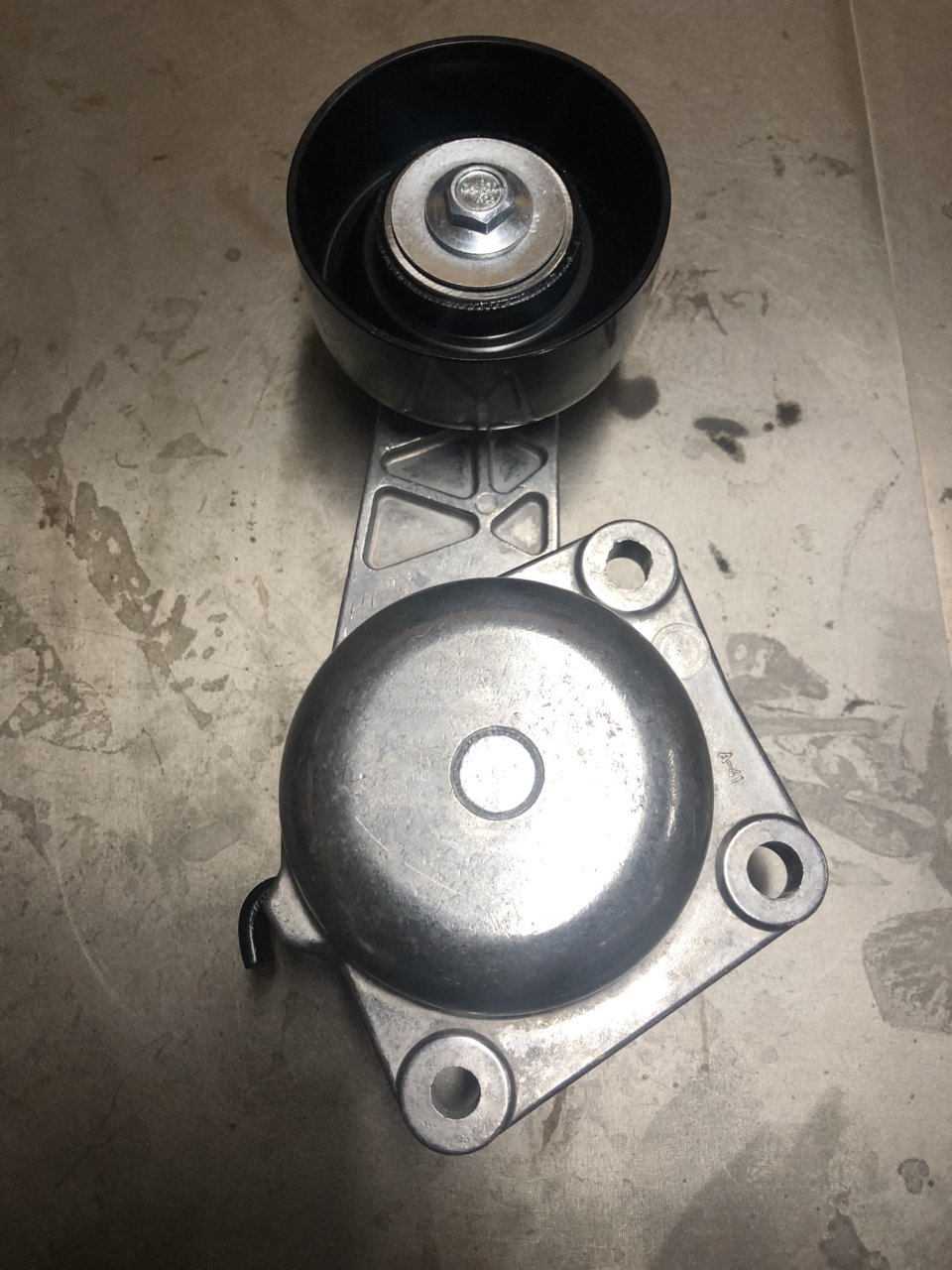

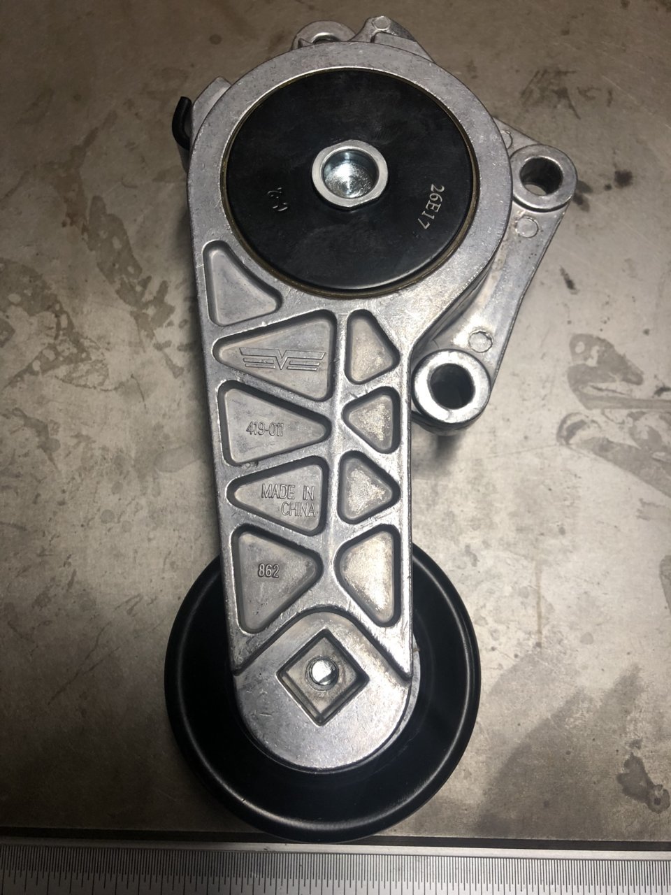

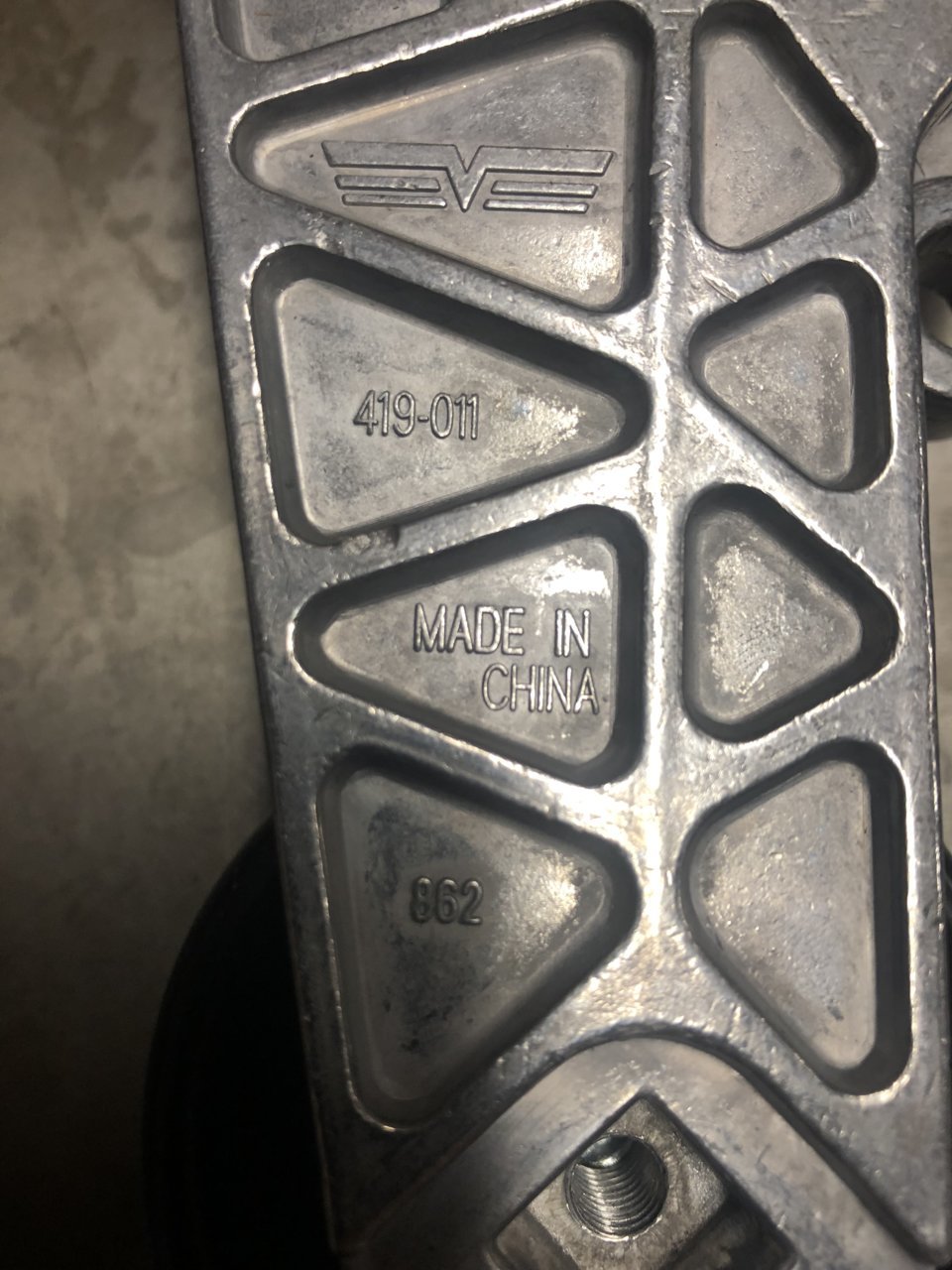

    this is one of my thoughts as well. Especially if it means theres no need to fuss with the spring/mechanism. I'll order another tensioner to play with it.. Let me know if you can separate the 2.. I would much rather just make a replacement arm.
    that was mine. first was original one with the blower.. second one had to of been a new version as it was recent.
    I will check to see if I can find info on where mine were manufactured.. but regardless, I think its just the process and added stress.
