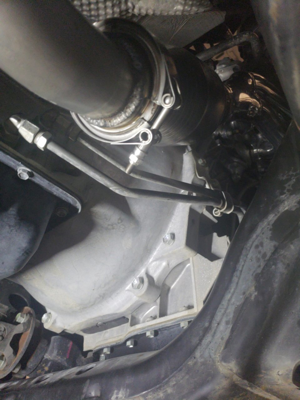

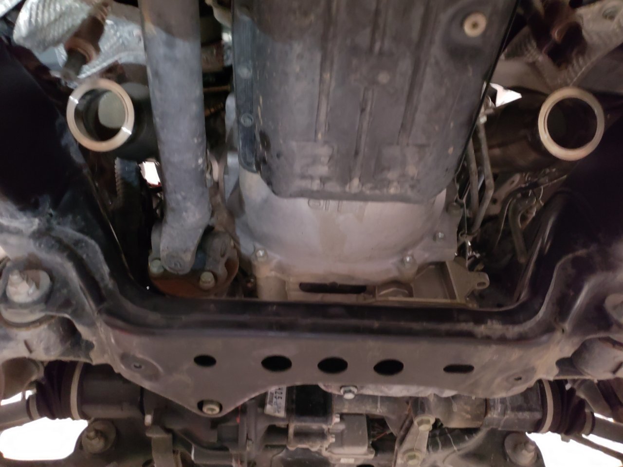

    Urd headers are a pita to install.

    Yes. Vibrant cats, a little tubing, and v-bands to a modified URD y-pipe.

    The installer has to be carefull lining the cats up correctly or you will have issues with the rest of the exhaust as @Murphinator has first hand experience with this.

    Thank you gents.
    I’m wondering if I can do the welding myself. . .?
    I figure I’ll be way more attentive to detail, unless this is a simple thing for exhaust shops to do????

    Depends on how comfortable you are installing/removing header. Just make sure you make some sort of jig, and that you will be able to mount your transmission to header brackets back on. My driver side doesn’t line up so it has caused me some grief.

    Good thinking. Does that problem cause a performance issue or is it a “not how it’s supposed to be” issue. Both are bad, but one is a slightly easier pull to swallow

    No performance issue, just annoying things like your catback rattling on the driveshaft support bearing crossmember, slowly driving you insane.
    No joke at one point it made me want to just sell my truck. Well that and some other things, but it was the icing on top basically.

    Yep. Same shop did a set before mine with no issues. I guess the studs in my truck gave them problems so the dude was fustrated with my truck. When I learned that support bar was missing, it was too late to do anything. I called him and he basically said he could fix it if I paid him the full price again. No thanks

    My mechanic did the work and took a bunch of time with mandrel bent tubing to get the bends just right and keep the flow unrestricted. I'm ignoring how much I spent on that... Onward!

    Yup. Better have straight cuts, and keen alignment.
