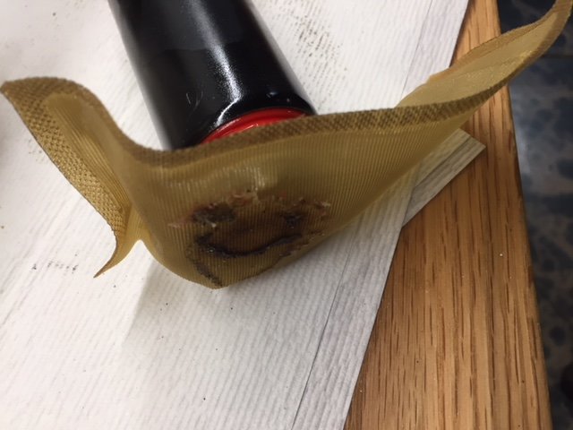

    Cats definitely look like a strong suspect. You've certainly done a lot of trouble shooting already.
    The inline fuel filter isn't where you'd see the first issue with fuel delivery. The inline filter protects your injectors/regulator. My issue happened at the bottom of the pump in the tank. The pump had worked its way to the bottom of the tank and the screen that came with the pump got fully blinded. Somehow got a bunch of junk in the tank and probably had a bit of coating rubbed off the outside of the pump. Either way, when I was on the trail at a slightly inclined angle, the engine would actually cut out on me. Glad I didn't get stuck out there!
    Also, with your AFR not falling off, this probably isn't it!
