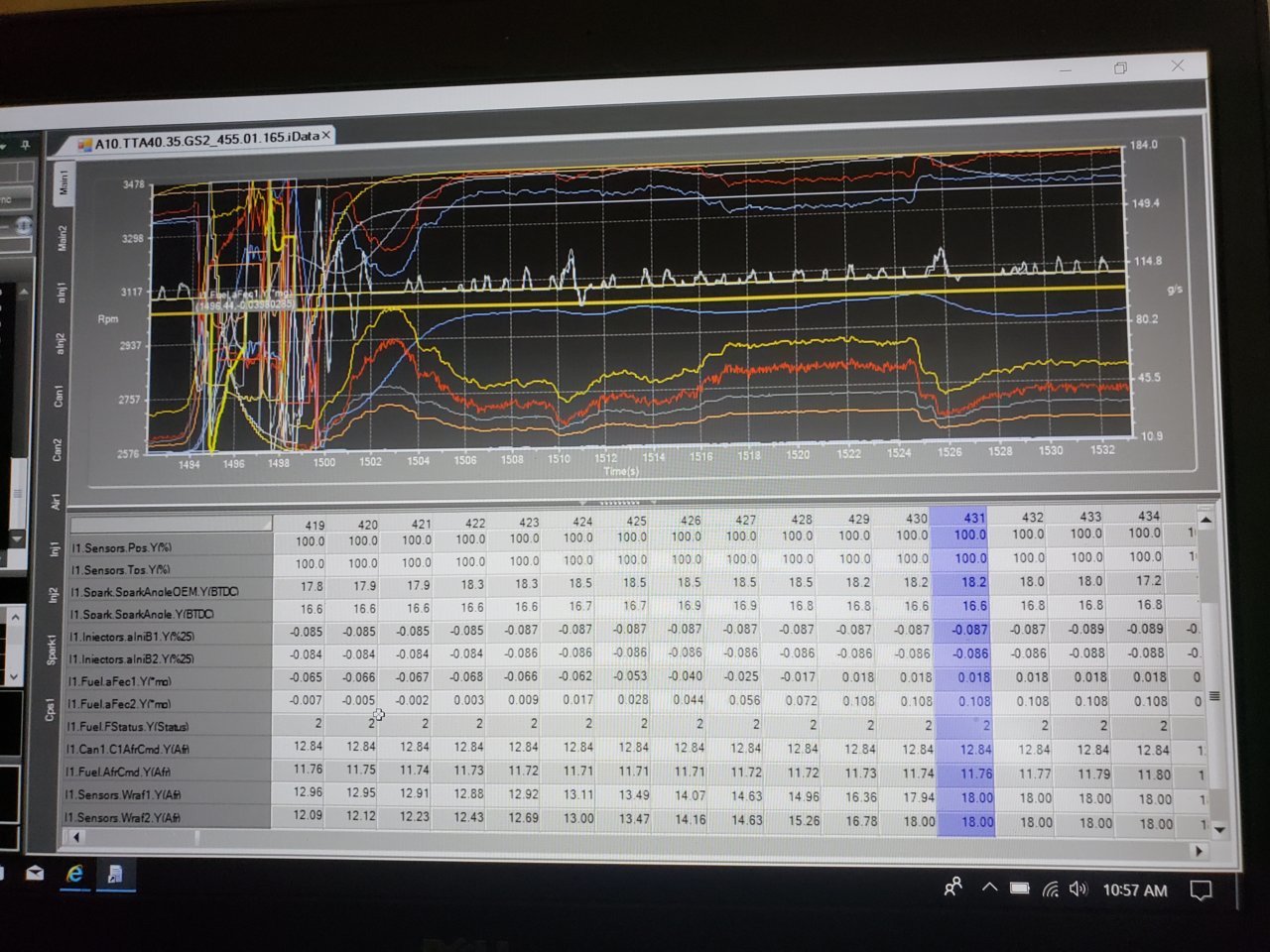

    The UCON was commanding approximately 11.75 afr. The WRAF's for whatever reason as you can see on the bottom 2 lines showed a rapid leaning condition. The UCON will engage the Guardian feature if it cant control the afr.
    So the UCON commands a certain afr and reads it from the wrafs then adjusts idc to achieve desired afr. If the UCON cannot control the afr meaning its leaning out away from its commanded afr it will shut things down to prevent a blown motor.

    Every bone in my body still says that the issue lies in the UCON software, not an engine hardware (sensor or item) issue.
    There is one question that we have forgotten to ask @rjbiii I think though.
    Did you get your UCON before, or after you got the TRD tune supercharger file flashed into your PCM?

    You know, the possibility exists that the OE computer in @rjbiii's truck is the issue and since the UCON is in play we are blaming it for the issues. Maybe he just has a defective unit. There are only a few things that will cause a lean condition like he is having.
    - MAF (ruled out)
    - Fueling issue (ruled out)
    - Oxygen sensors (ruled out)
    - Vacuum leak (ruled out)
    - Computer issue (Not ruled out)

    To me, this looks like you've got a fuel delivery issue. Can you send me this log so I can look at the whole thing? PM inbound.
