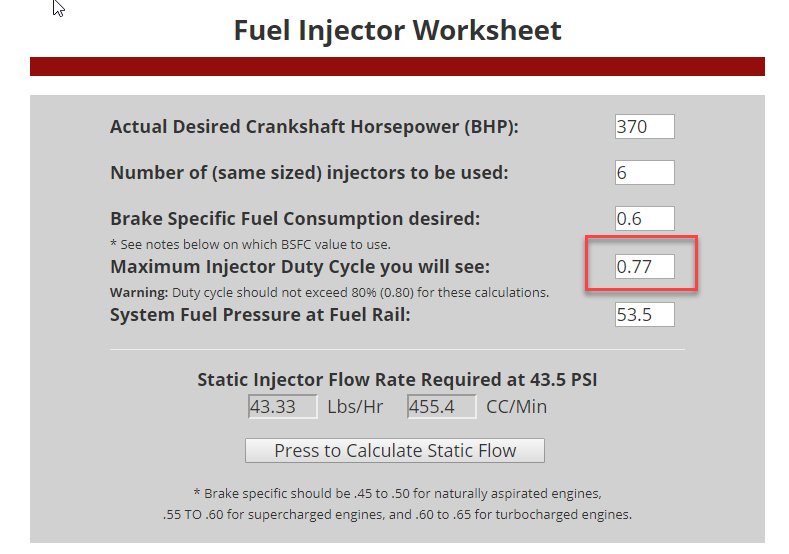

    Based on my dyno, was at 86% duty cycle on the 455cc oem SC injectors on 2.7 pulley without FPR. AFRs were slightly lean for both TRD and OVTune which had very similar results on my setup.
    Interested to see how much the FPR mod actually affects duty cycle for those of us still running 455cc injectors on smaller pulleys. I plan on doing another dyno after I get the JFR y-pipe - in addition to having already stepped down to 2.5 with FPR

    So to compare for FPR, if I add 10 psi to fuel pressure for this same case, it decreases injector duty cycle from 86% to 77%. Not a significant drop-off using FPR. And the BHP is for 2.7 pulley.

    Interesting calculator! Thanks for sending this along. Thing is, I was getting almost that BHP with a 2.825" pulley - tested by dyno to 309whp, if you add about 15% losses then that's 355bhp.

    Thank @Torspd for showing me this calculator.
    I dynoed 314whp on the 2.7 non-boost referenced and thought the numbers were underwhelming (although it was about 95deg that day), but I was also running lean. The website with this calculator also says "Most injectors will max out at 80% duty cycle and this is the accepted industry standard."
    I'm thinking of throwing in the 61lb injectors next time I have the blower off just as insurance
