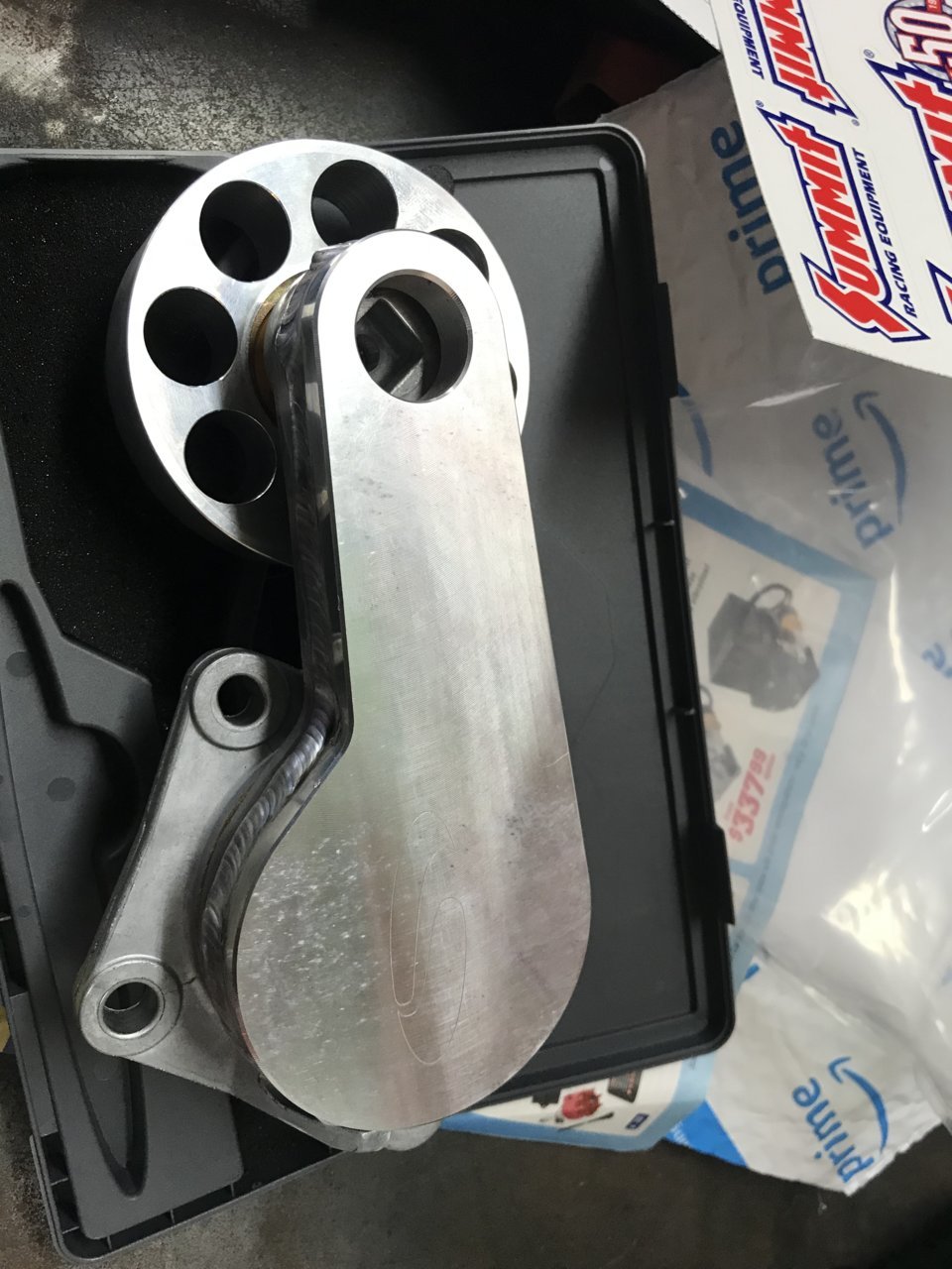

    https://www.ebay.com/itm/LFP-50mm-B...998187?hash=item5b22cebd6b:g:Hs0AAOSwAvJXAzrW
    I confirmed it will fit in there despite tight tolerances today when I switched back to the stock tensioner temporarily while I receive this pulley. I'd rather have full tensioner sleeve engagement into the pulley than decreased engagement and risk losing an idler while under boost.
    The Thump tensioner added a surprising amount of stability to the amount of boost being driven through at all times. It also slightly raised the tensioner resting height using the current fleetrunner belt I have been using so that tells me that it actually added a bit more tension to the setup at all times. I can't wait to put it all back on and may throw an NST lightweight pulley for faster revving at all times since I will be in there, again. :thumbsup:
    Much better! :thumbsup:

    Oh and @Roostfactor I already confirmed bearing sizes being the same.
    Our idler pulley bearing utilized in the tensioner arm is a 6203, which are the same style which will be utilized in this 50mm double bearing billet idler pulley, so fitment will be a non issue.

    Yup that’s correct 6203. The bearings Toyota use are pretty great. But if you’re going aftermarket make sure they can handle the higher SC rpms

    Is that a crack, or a casting rib left over?
