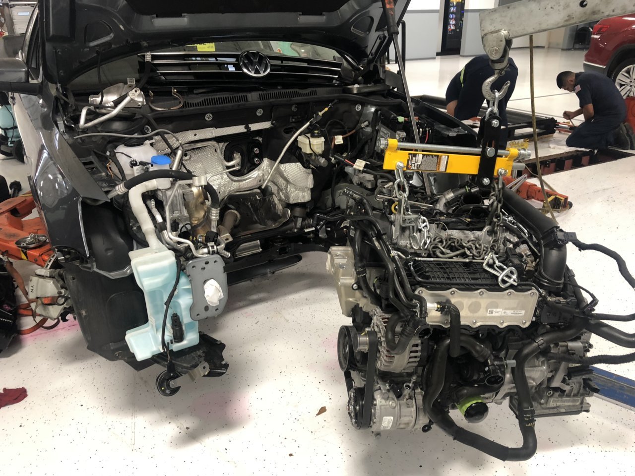

    This is my project for today. Not supercharged but it does have a tiny little turbo. :D
    7k miles on it. Needs a longblock. Customer took it to a quick lube place for an oil change. They poked a hole in the spin-on oil filter when installing it. Customer drove it till it was out of oil. It still runs but it makes a lot of aftermarket noises.

    How the HELL does one poke a hole in an oil filter while installing it?

    Those filter pliers can do some damage. With great power comes great responsibility. The lube place is paying for the engine replacement. Or their insurance is, rather.

    Yep, basically anything that could be contaminated with metal particles is getting replaced. Long block, breather, turbo, oil lines etc.

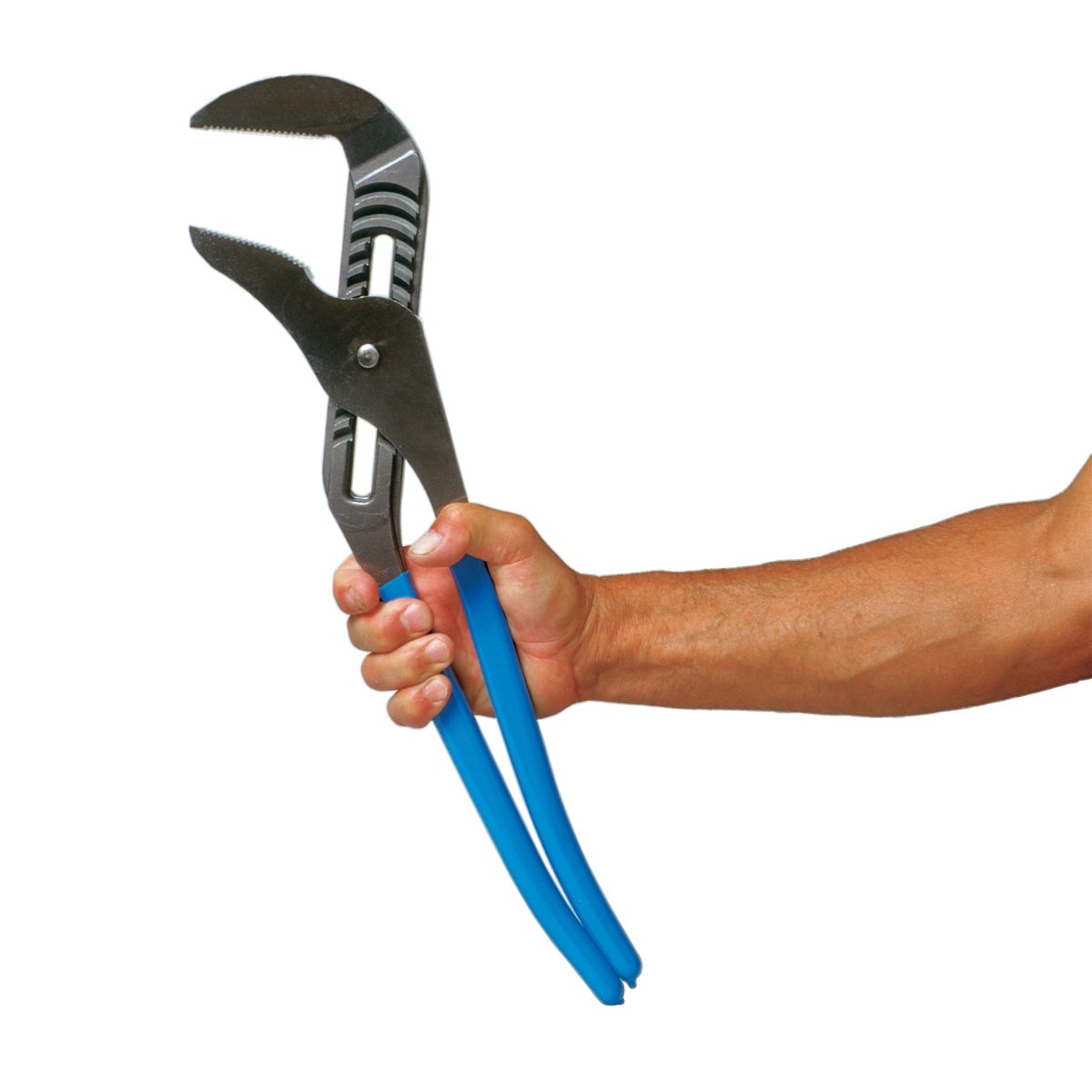

    I use oil filter pliers every day, but I don’t he-man it. Only time I’ve ever poked a hole in the filter is when removing one that’s tight AF.
    I have a set of Channellock 480 Bigazz that are great for getting the stubborn ones off.
    https://www.channellock.com/product/480/
