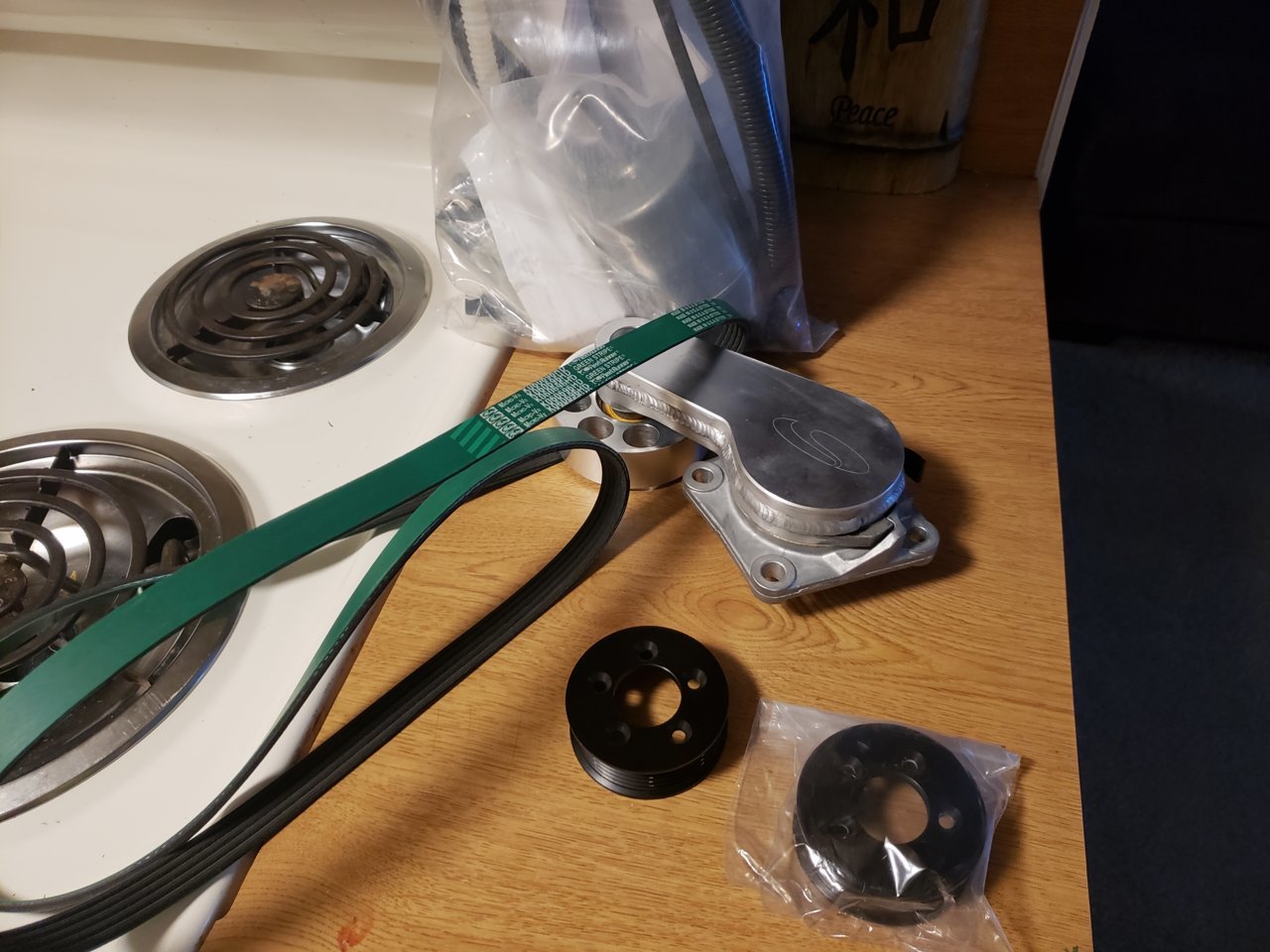

    If success, I make a movie film.

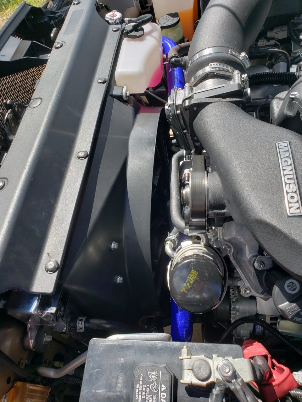

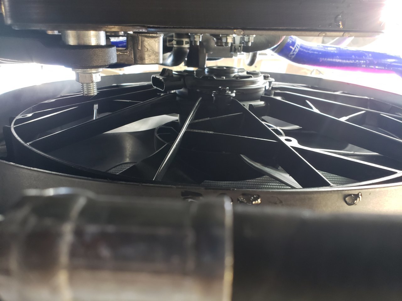

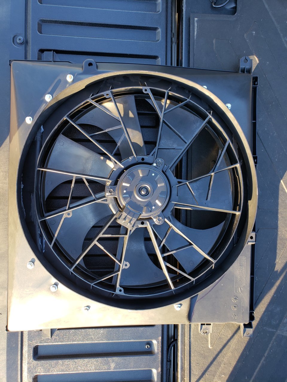

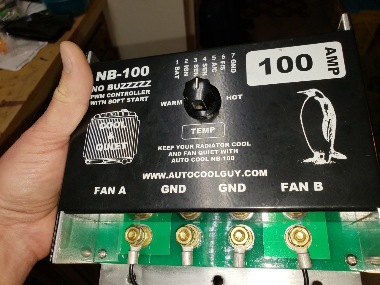

    With my Efan my a/c SHOULD blow icicles in the summer. I used 90's Thunderbird fan.
    It was a pain to fabricate and install though. Also I have a pwm fan controller and my first fan motor died after a month or so.
    I just replaced the fan motor only for a MarkIII fan. I'll see how it lasts.
    It is a good thing I always listen for the Efan running when I shut the truck off or I wouldnt have known the fan motor failed!
    There is a lot of truth to the reliability of the the clutch fan BUT efan works better for a/c and low rpm use no doubt.
    My controller automatically adjusts fan rpm so it only runs as fast as needed to keep the engine cool and a/c trigger turns up fan speed to whatever you adjust it to.
    20180914_143036.jpg 20181021_223927.jpg 20180910_190445.jpg 20180914_142932.jpg

    I have two. :spy:

    I really like that controller!

    Yeah I'm not sure if the pwm controller burned up the first motor or not so I switched controllers from an AutocoolIII to the NB100. The NB100 has capacitors in it to smooth the power output pulses.

    Thanks for the controller idea.
