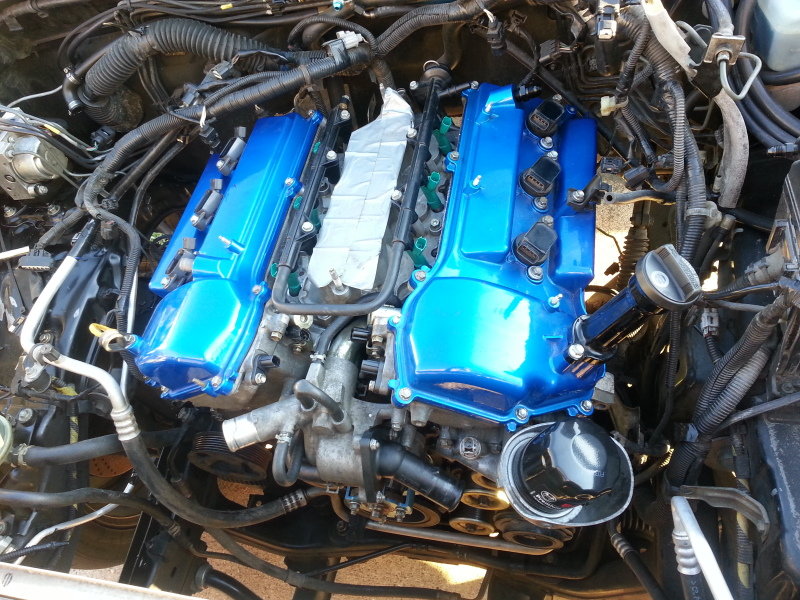

    I painter my valve covers but didn’t come out the best. Gonna have then powdercoated I think. Trying to find a good color to match speedway blue. Having calipers powdercoated now do will see how they look. Hope they match

    I’d go blue too.

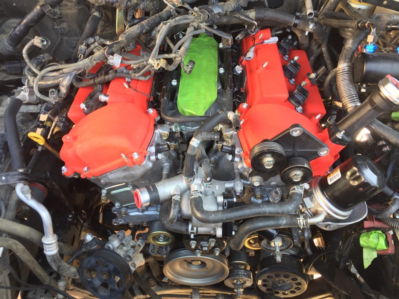

    Yeah, I used VHT wrinkle paint. It turned out ok. I didn’t mask off the perimeter bolt holes and a couple of them drew the paint up during install. Overall, the product looks reasonably descent. I used a ton of degreaser and wire brushes to clean the varnish off them and create key. Sprayed, then baked them. Texture turned out relatively consistent. We’ll see if they last. I have another pair I can actually powder coat. I just didnt want to have to deal with getting sandblasting media in the oil separator chambers.

    Ford blue engine spray paint. Looks good but I’m anal about stuff so need it perfect.

    VHT Wrinkle Red:

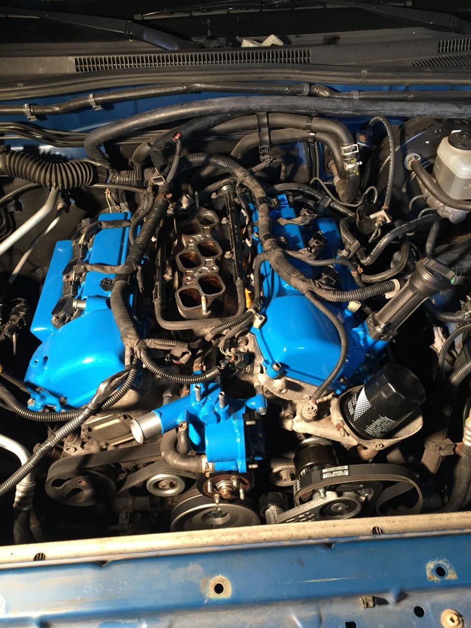

    A match you say?

    Awesome! ....very cool. Just the look I’d be wanting to shoot for myself. :thumbsup:
