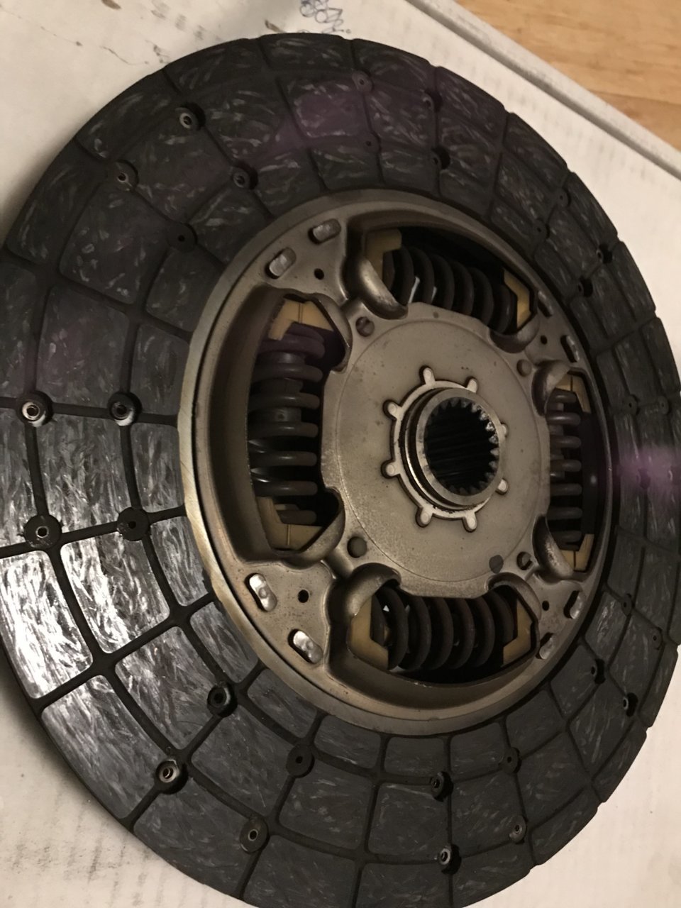

    That looks like the transmission input shaft, so i believe this is the side that makes contact with the flywheel. Please correct me if im wrong Tron.

    that looks like an alignment tool if I'm not mistaken?
    but not sure what side those pucks go on?

    Youre definitely right thats not the input shaft @richiep
    Please forgive me haha, i didnt even look behind the pressure plate. I spoke with gadget earlier today though and he told me that is the side that contacts the flywheel so i am fairly confident that much is correct.. my foot is currently in my mouth lol.. :anonymous:

    no big deal, I'm totally perplexed about how that disk wore out like that, maybe improper free play? or maybe driving with foot on pedal?
    imo if the disk was poor quality the spring assembly would grenade? @Torspd

    Im also interested to hear what could cause such a premature failure. How many miles did you take it easy during the break in procedure? @TRON

    Here is my stock clutch for my first 55k. Even though this clutch was fine I decided to swap with the URD stage 3 when I replaced the first throwout bearing with TSB. There are many variables that could be the blame. Maybe Toyota didn’t install the clutch just right. Maybe the 2nd throwout bearing with 50k on it going bad caused it. I don’t know. I do know my clutch pedal has to be push down at least a third before it even starts to engage. And I don’t drive with my foot on the clutch pedal lol. Regardless, it’s all good. Live and learn

    Magnuson supercharger, 2.6 quick change pulley, 76mm throttle body, Doug thorley long tubes, urd y pipe, wot box with 2 step, 170 thermostat, airaid intake, urd short throw, djm 3/4
    What I picked up a couple of years ago from a friend. Has about 600 miles on it. He upgraded to stage 3+. Debating on selling it now tho after this.

    can you please post pictures of the opposite side of that disk, the pressure plate & flywheel? I'm very curious to see the surface's.

    I apologie, I meant the urd disk

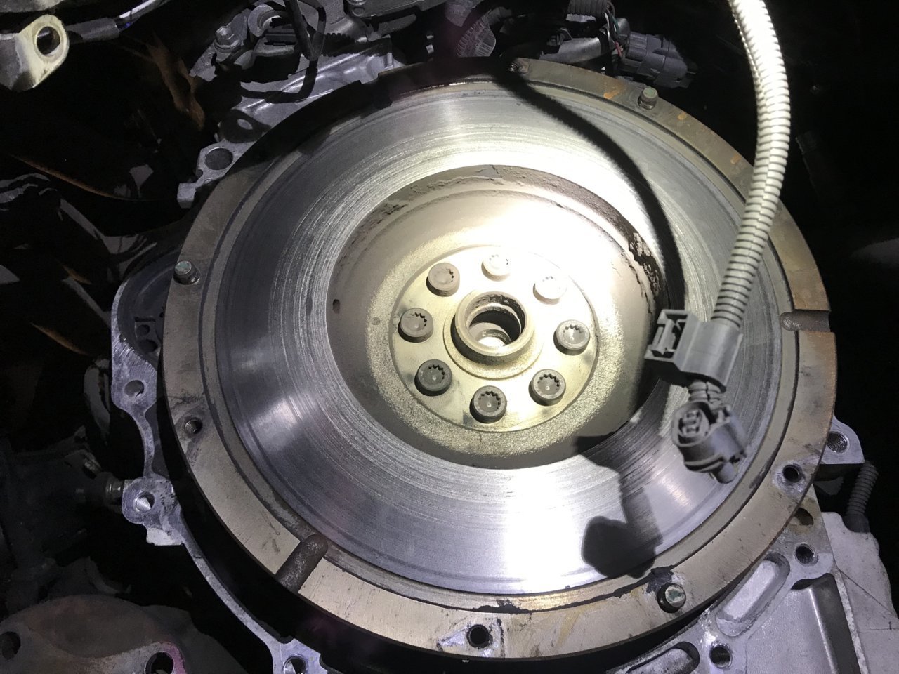

    TRD Blower, 2.3 Pulley, NST OverDrive Pulley Kit, B&M Shifter, TR Lowering Kit, Spec Clutch, Xrunner Body Kit
    Flywheel couple days ago. It’s getting turned as we speak. The URD clutch disc and plate are at the shop. The other side of the URD clutch disc looks a lot like stock.
    One thing my mechanic said after removing the tranny was the red fins on the URD pressure plate were sticking out more than normal?

    362
    Rich
    NY
    2006 Tacoma Access 4WD SR5
    Trd s/c 2.85 pully Walbro 255 f/p Urd stage 3 clutch Hurst core shifter Afe cai
    looking at the original picture of the urd disk, it appears like for some reason that it was slipping to wear so much, but if the back side wasn't as worn & after looking at that flywheel, there really isn't any evidence of that much slipping. the flywheel doesn't look burnt like it would from clutch slippage.
    I wonder if the pressure plate was defective?
