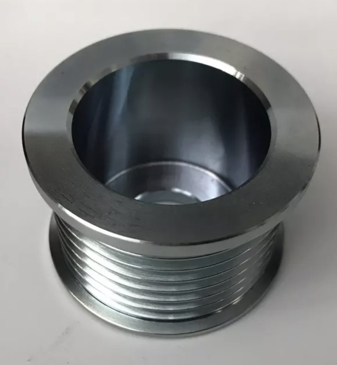

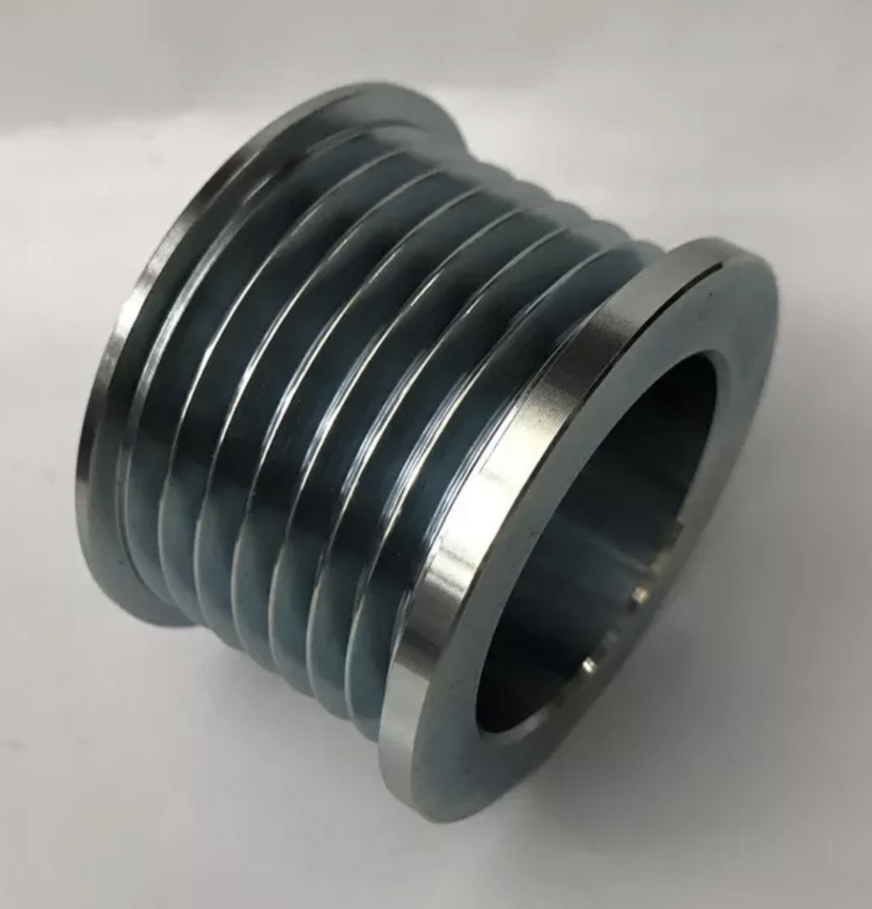

    Found a possible alternator pulley candidate.
    45.5mm OD
    vs
    52.0mm OD (stock)
    Most of the ones I’ve found are 48mm OD, and painted black. This one is a tiny bit smaller for moar powah.
    Seller said it should fit, but it may need spacers to get the correct alignment with the other pulleys (spacers included). This one was a twice the price of the others I found, but it’s really shiny. If it fits, I may need to upgrade to a matching LTR coolant reservoir.

    Don’t forget to upgrade your wiring by doing the big 3. If you don’t, there’s a 120amp (FJ) fuse on the alternator circuit. Obviously, voltage is regulated as well, so I think the best outcome would just be more amps available at a lower rpm provided you need them. Also you’ll probably need to look at your belt size to make sure you don’t need to go down a size.

    Extra ribs are no problem I assume?

    Way ahead of you! :thumbsup:
    Belt and pulley are both 7 groove. :thumbsup:

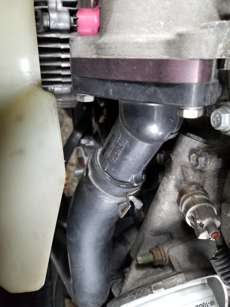

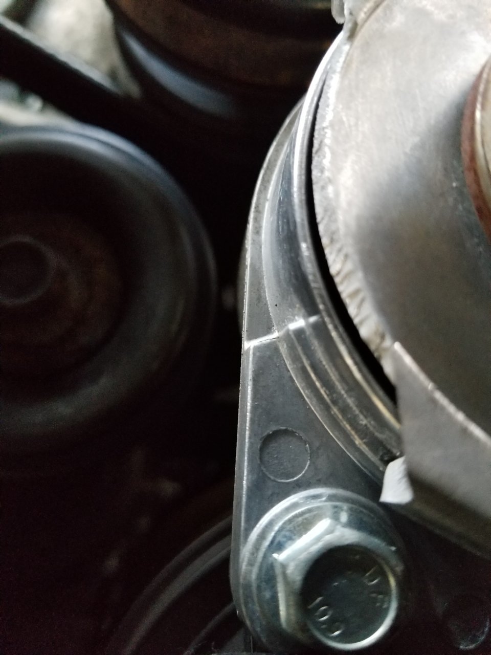

    here is a better few

    Yep, same point as others. I have to wonder if they didn't get a bad batch of castings. I would call Magnuson and see if they can help you out on this. They have to know this is becoming more common.

    Looks similar to where mine broke....don't order one through Toyota, you'll just overpay for it. You can get the same tensioner on Amazon for $35 (its listed at the bottom of this page), you just need to swap the old pulley onto it. However, as mentioned there are other options for a stronger tensioner discussed in this forum
