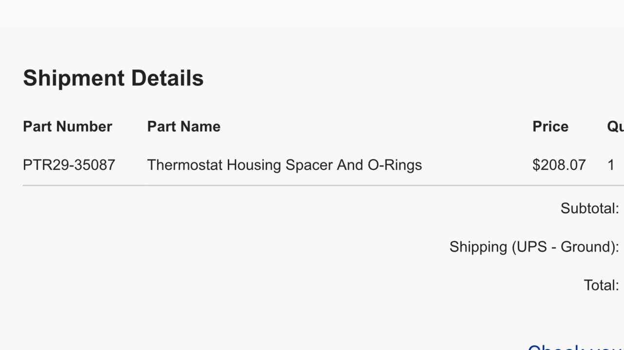

    So, if you need a replacement spacer kit like I did, you can either purchase the Toyota part PTR29-35087 for retail $314 on sale at $220 here:
    https://trdparts4u.toyotaofdallas.com/product/trd-thermostat-housing-spacer-w-o-rings-kit/
    Or you can buy Magnuson part number
    31-90-40-031 For about half the cost at @ $125 here:
    https://trdparts4u.toyotaofdallas.com/product/bag-g-4-0-supercharger-thermostat-spacers-etc/
    I swear I found a place that had them for the $80 range, but I can’t find it anymore.

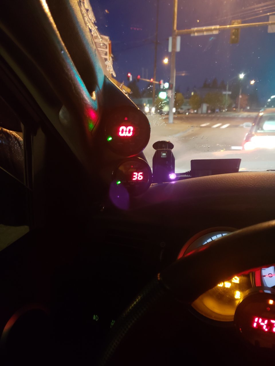

    S/c output temp. Stay boosty my friends.20181108_062012.jpg
