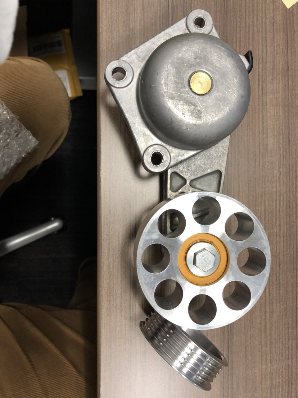

    I talked about it below.
    Very nice. Don't forget to change that pulley out with your stock one! Make sure the belt lines up prior to slapping it on and running it!
    The obvious mentions are increased under hood temps due to constant boost production, reduced fuel economy and excessive wear on the bearings due to increased load being placed on them. There will be no surging, however.
