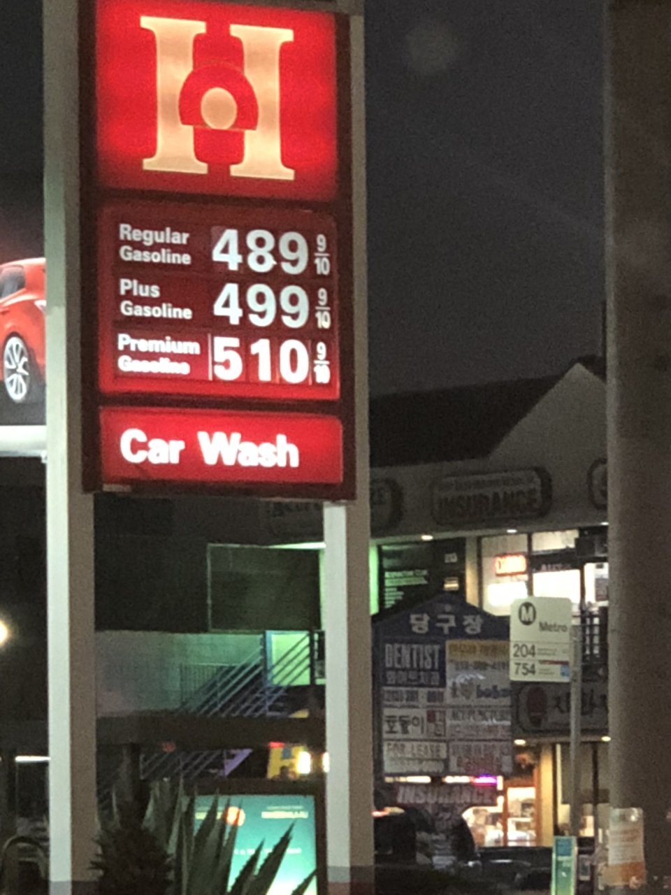

    Love LA ...

    Owch.

    It’s not normal .. but I’m seeing more stations jack up the gas price a whole $1 more. Bastards ....
    I’m just glad I have a company vehicle(with a gas card) as my daily.

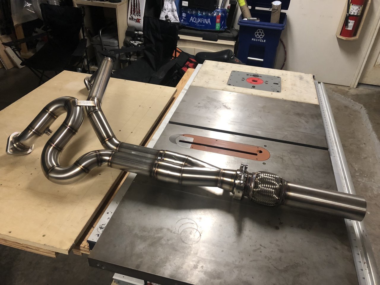

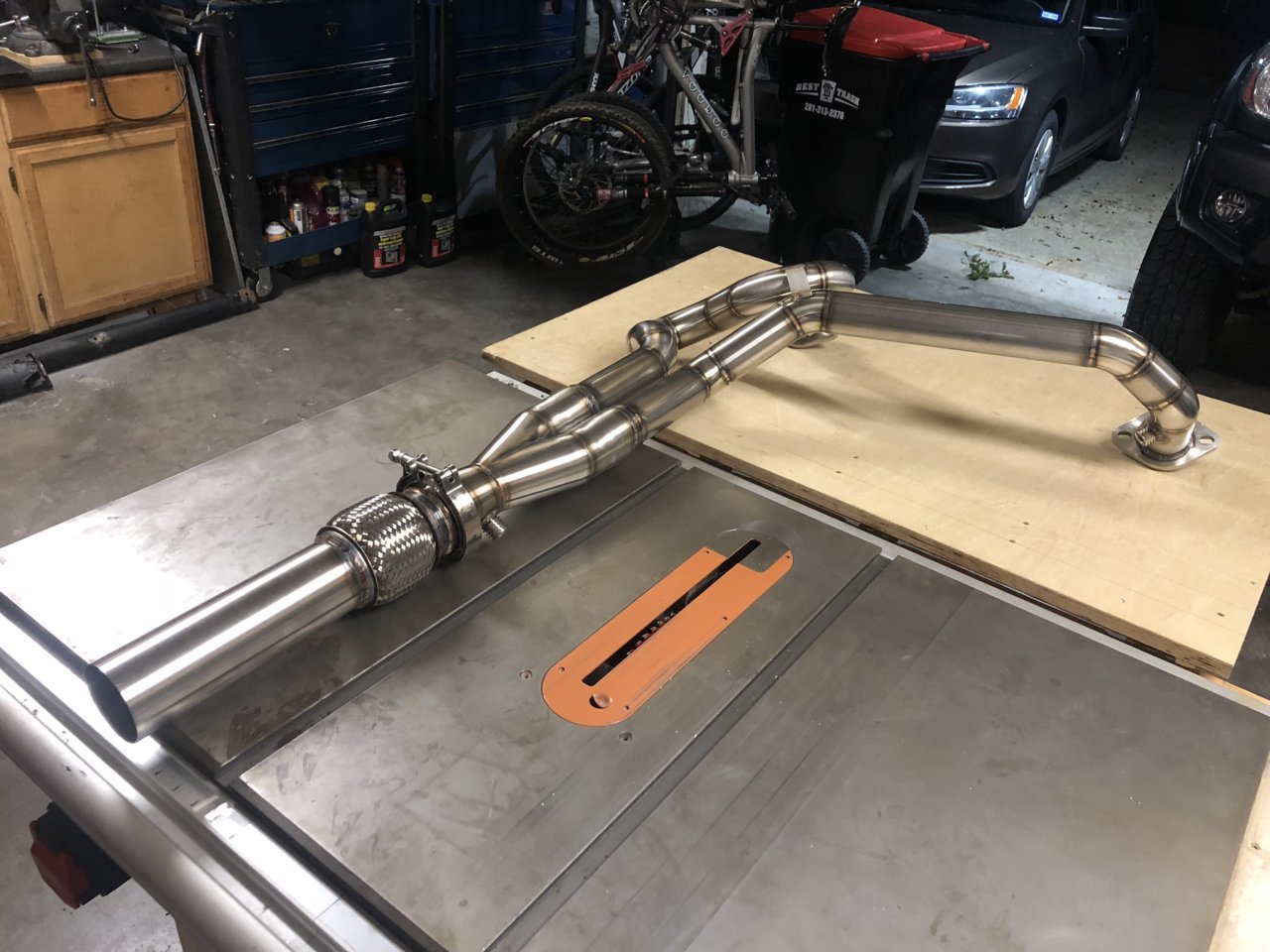

    I commissioned an artist to make me some wall art for the garage.
    Lookie lookie here!
    D6B768EF-56AB-41E3-830D-6F162CB93253.jpg E326C0FD-28A6-4C3B-B62A-7920E55950BC.jpg
