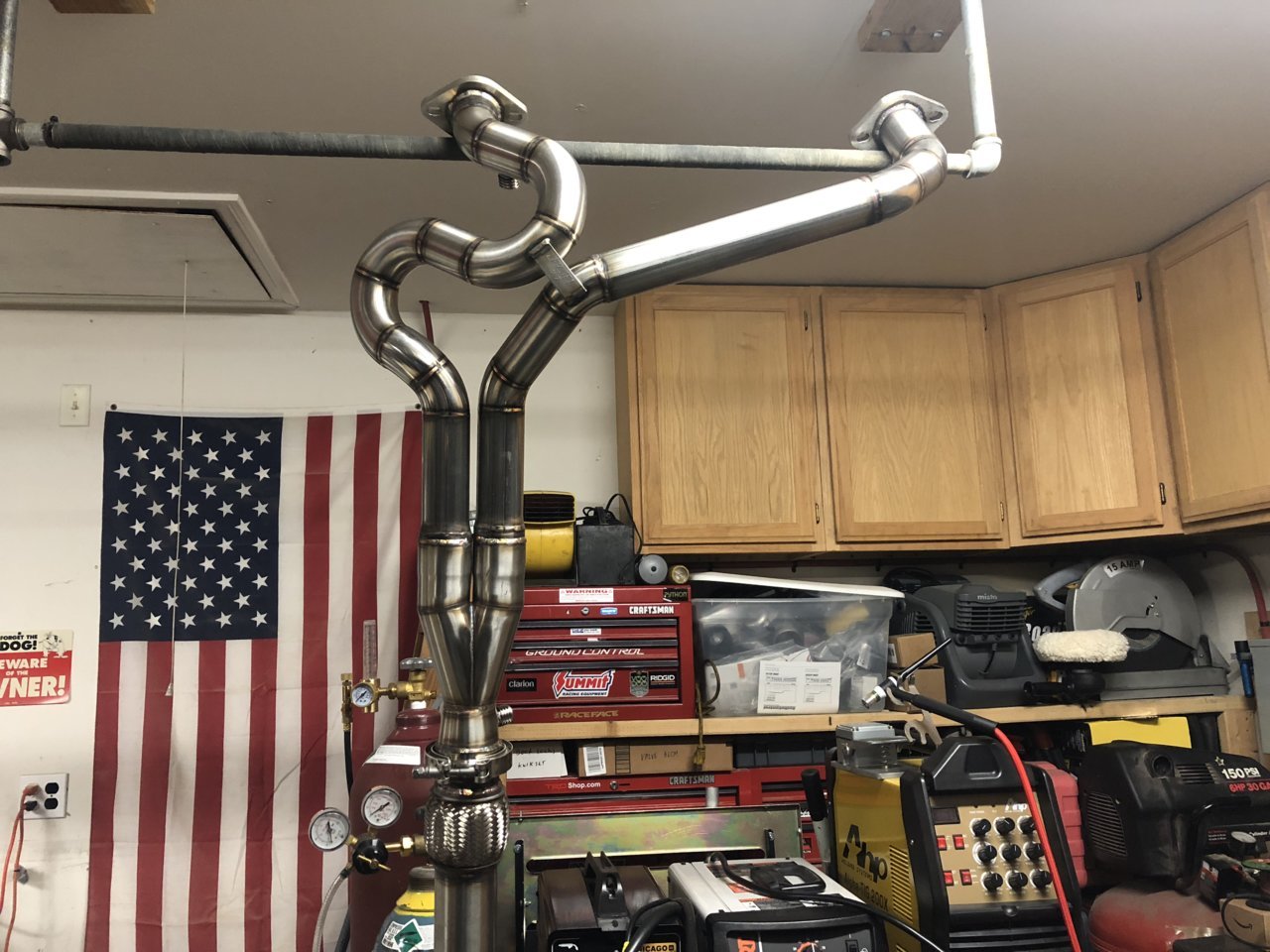

    What does the Chinese finger trap looking part do? The end near the muffler connection.
  9. Nov 8, 2018 at 9:39 PM
    #9169
    12TRDTacoma
    12TRDTacoma [OP] Powered by Ford, GM, VW, and Mercedes
    Aug 20, 2012
    #85133
    16,671
    Rob
    Concordia
    12 TRD Sport DCLB 4x4 Supercharged
    Boosted
    It's a flex pipe, which allows the exhaust system to move around as the engine torques or the truck moves around due to bumps in the road. A system as long as ours should never be solidly built or else the piping can break somewhere, usually at the welds.
