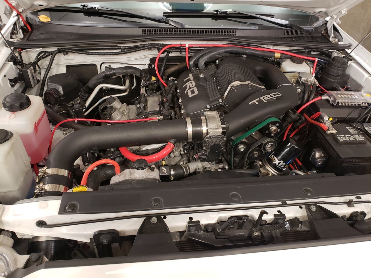

    Getting in the Christmas spirit with the engine bay.

    Huge thanks to @crashnburn80! Couldn't have done it without him. Fuel pump and pulley/belt swap. Truck seems to run better with a 2.5 pulley. Afr gauges are more stable. Love the new frequency this thing makes!

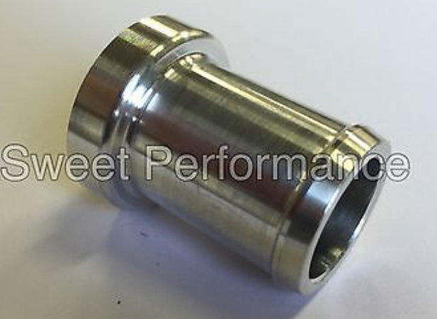

    Looks like it’s right at 2 liters. Ordered some of these to weld in, they’re about 5$ on eBay

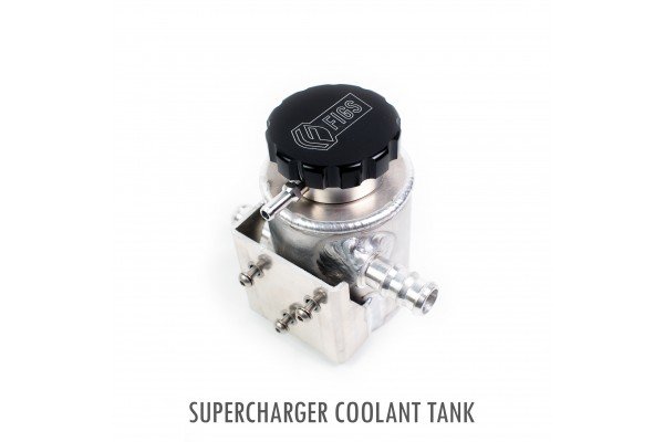

    You people and the reservoir. Just go Figg. Quit thinking too hard.

    I just did a battery relocate and the same reservior install that 12TRD did anyways. Hated that leaky little resin soda can they call a coolant reservior.
