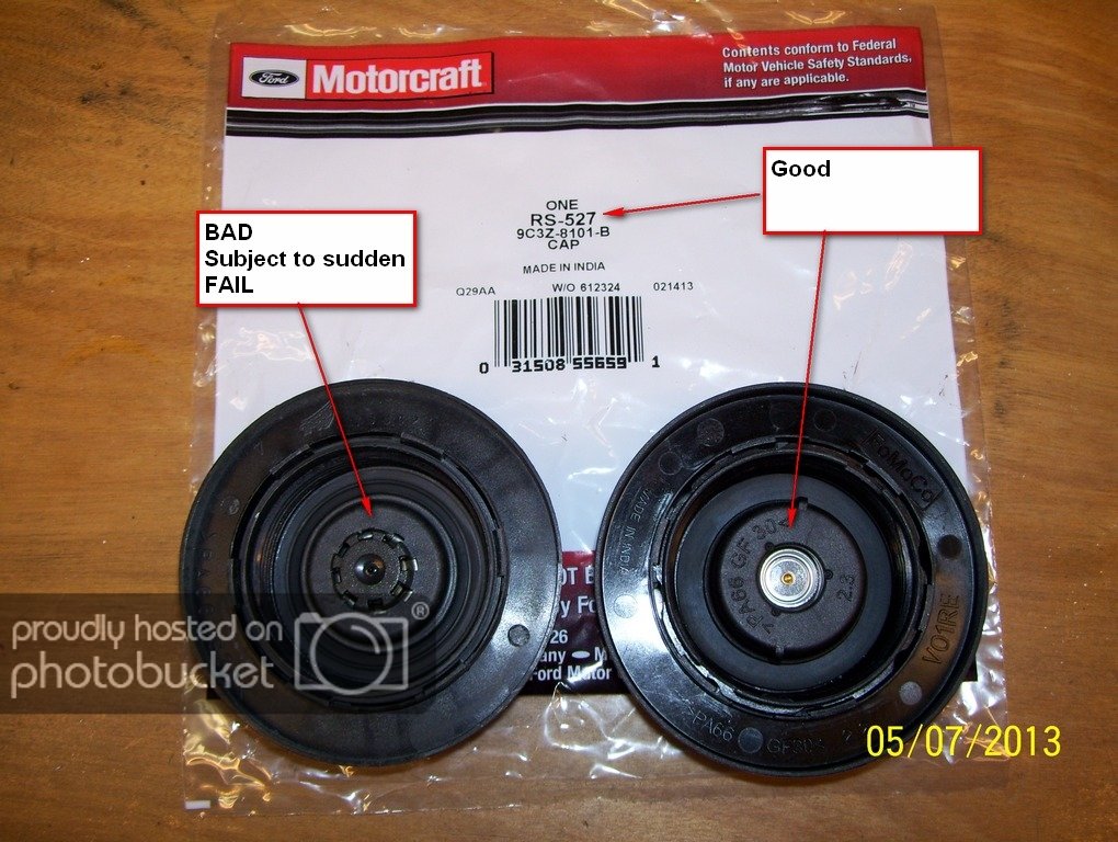

    The figs can has a normal radiator cap right? So it needs the overflow port open to be able to allow high pressures to vent. The ford style cap that comes stock has both a pressure relief and a vacuum relief. I think we have the old style caps. Ford released a newer version that fixed a lot of the leaking issues that the first one had. Here’s a new versus old for those that care. I have not tried one these for the record, but might be nice to try.

    It is a normal cap. You can order the reservoir with and without the overflow.

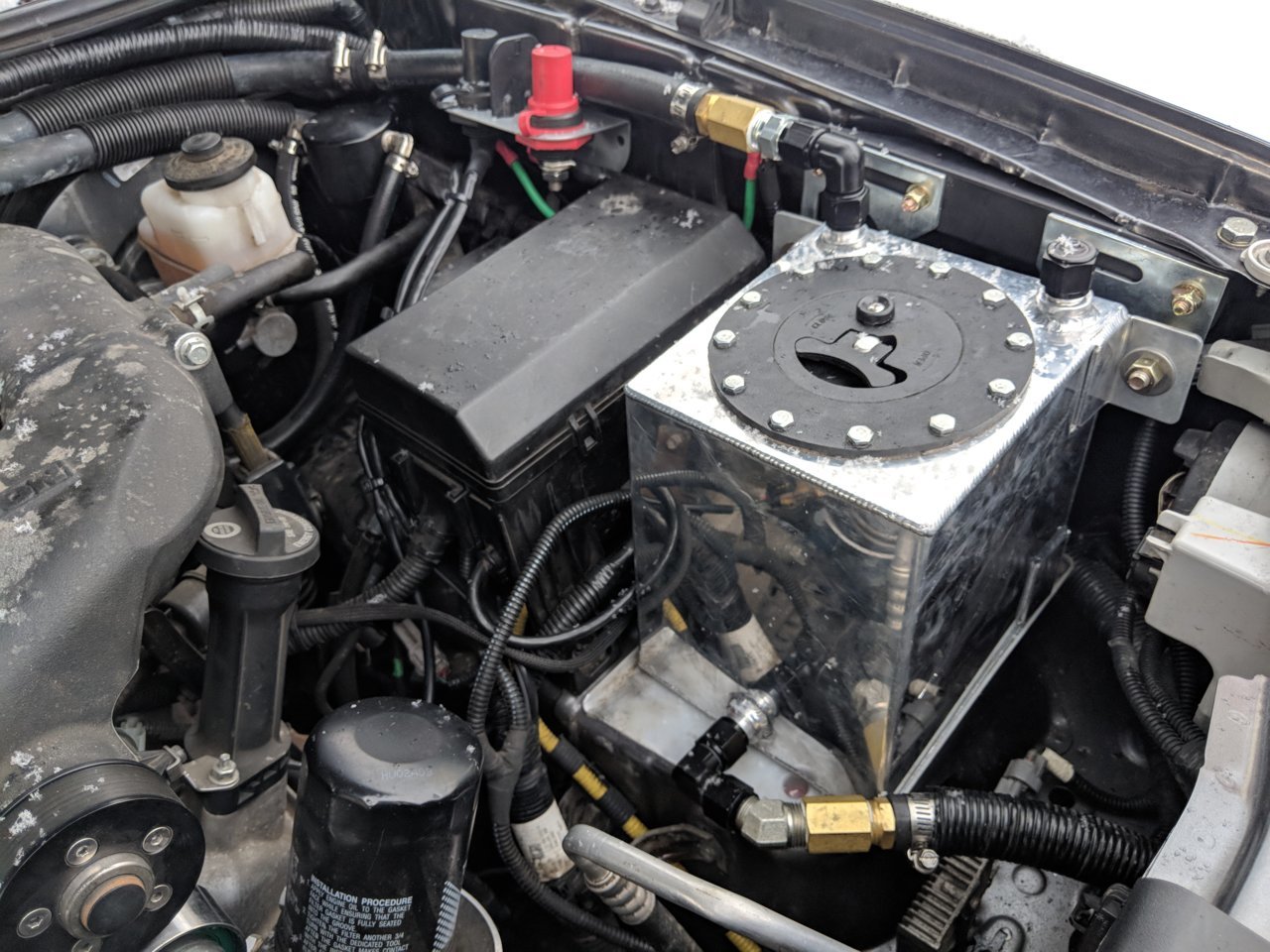

    My recent project which was mostly done two hours at a time when my kid was napping on weekends lol.
    Battery relocation to back of rear passenger seat
    Which led to relocating catch can (which I may tweak or move again), installation of a remote jumper station under hood, new larger aluminum intercooler reservior and higher flow pump and Roostfactor's pulley wrap mod.

    Did you tie onto the original battery cables or replace them from the starter too?
