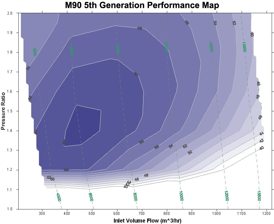

    It sounds to me like you’re trying to come up with reasons why not to put more rotations on the supercharger. The rationale should not be “why you shouldn’t”, but “why you should.”
