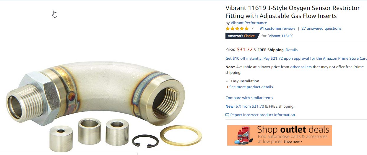

    Pablo at Tandem in Ft Worth claims he can build some stand-off tubes for the O2 sensor with small holes in them to where the sensor sees enough exhaust to adjust the computer, but not enough to throw a code and pass emissions. I still have cats, but I’ve thought about trying it.

    I'd like to see a diagram of that.

    You mean these?
