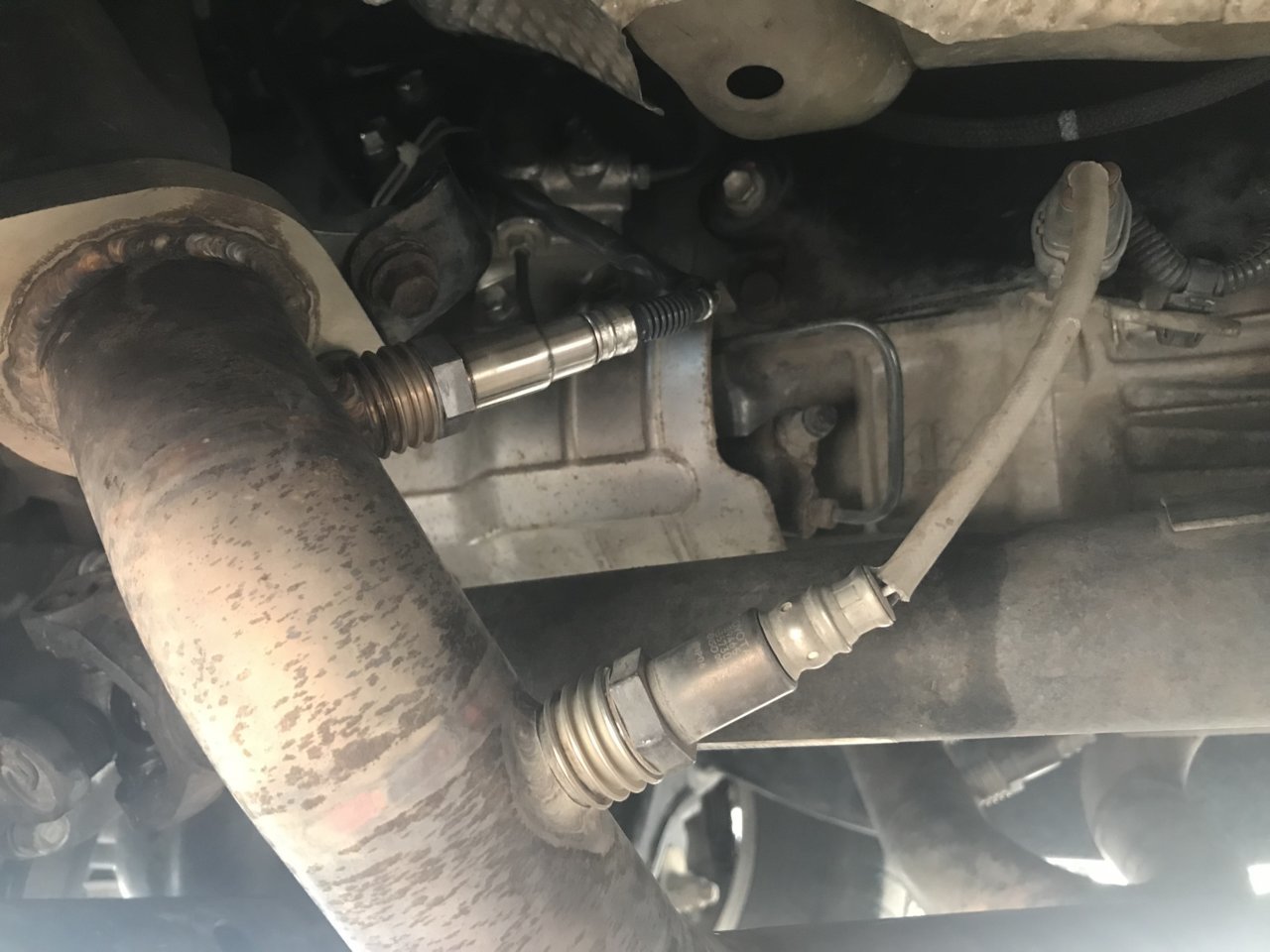

    That’s what I did too. The DT LT headers had bungs for gauge sensors. Passenger side bung was really tight so I ended up rounding off the plug and couldn’t get it out. So I had an exhaust shop add one on the Y-pipe just downstream of the flange.

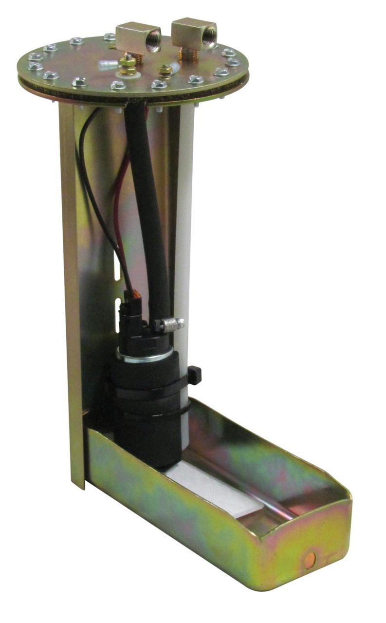

    Any of you tinkerers ever think of making your own fuel pump assembly similar to this?

    It would not be a bad idea, but how easy would it be to retrofit into our current design?

    Thanks buddy! Yes, i confirmed this on the way home today. AFR on passenger bank leaned out to 12.9 at WOT in third gear. AFR on driver side was a good 11.5. Guardian kicked in as usual. @Roostfactor

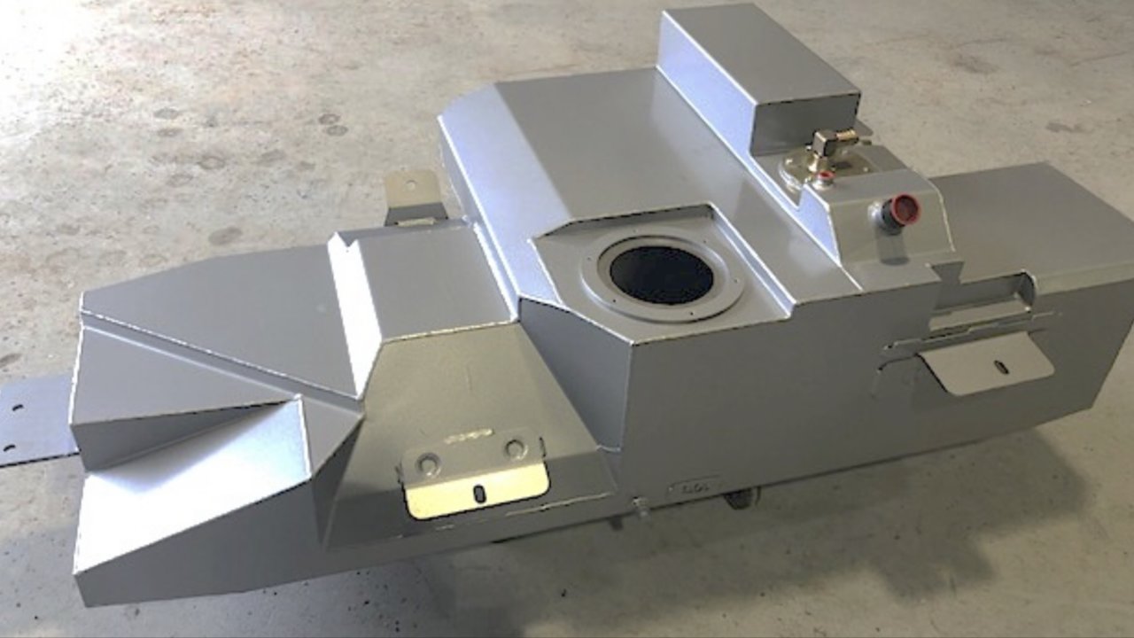

    Damn, thats nice! Thats the 34 gallon tank out of australia right? They were having a group buy on here for those.. i remember seeing a thread on it. i can try to track it down for ya if you'd like. Not sure if there was enough interest for it to pan out

    Shouldn't be too hard. There are some really trick fuel pump hanger already made for other models, but they can be pretty pricey. I was thinking of fabbing my own basic one, if I can find the right hardware. Would be pretty trick to run some nice -AN lines straight to the fuel rails.
    Example:
    http://www.radiumauto.com/Fuel-Pump-Hanger-FR-SBRZ86-P1142.aspx

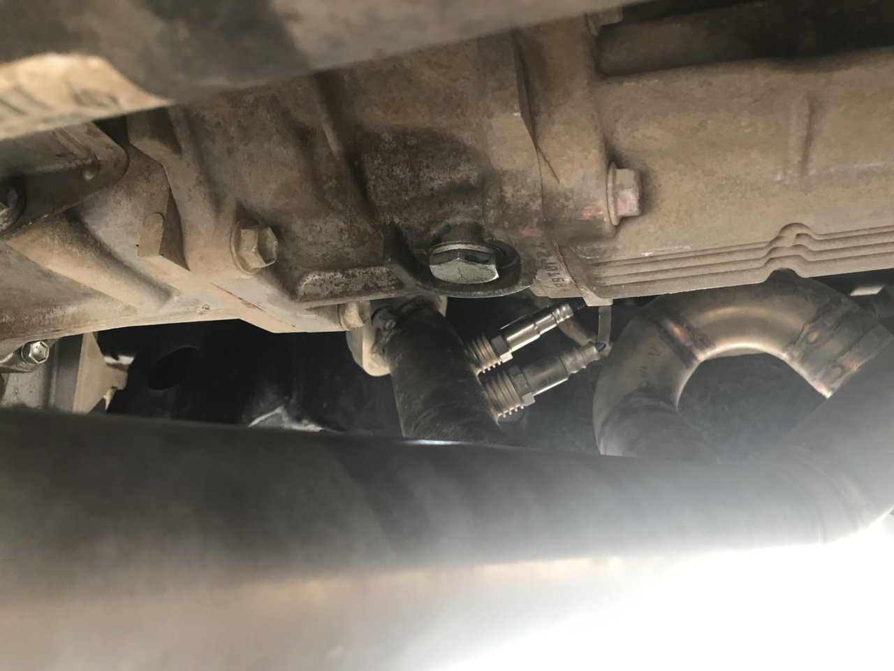

    Yes, one for each bank, super glad i did this as i am having a problem with one bank right now. Got the idea to go this route when i saw @Athlaos 's setup. Hes got one for each bank, and i was inspired:D
    Both AFR sensors are at the front of my JFR y-pipe right behind the merge on my URD headers.

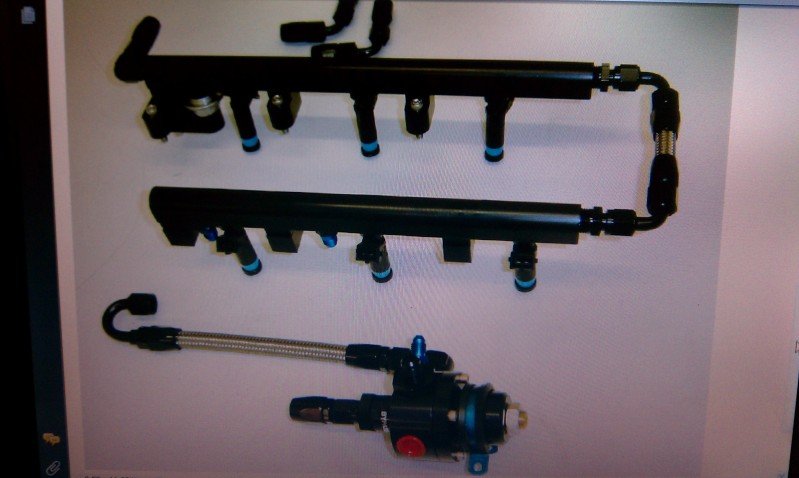

    Then of course, we'd need some nice fuel rails to match.

    Luckily I have just that. :cool:
