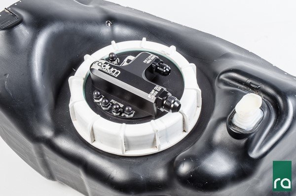

    I would maintain quick disconnects on my personal vehicle as I have found over time that AN connections just leak no matter what if they are aluminum. Really frustrating.
    I would love to have a legit fuel pump bucket that is designed for a standard fuel pump though because I was not necessarily happy with modifying the bucket to fit an aftermarket like I did. I haven't had any issues, but still.

    Better quality AN fittings should do the trick.

    Radium has something for a GR engine. I think. Otherwise, you'd have to search Thailand or Australia to see if they have one. Next would be having the rails made.
    By the way, I use -8AN lines going in and out of mine. Not -6AN.

    I use: Aeroquip(Eaton), Earl's Performance(Holly), or Aeromotive. If it is an NPT threaded end, it still needs a viscous pipe sealant or teflon tape.

    Oh yeah it was either Earl's or Fragola that I had used in the past. They eventually leaked.
