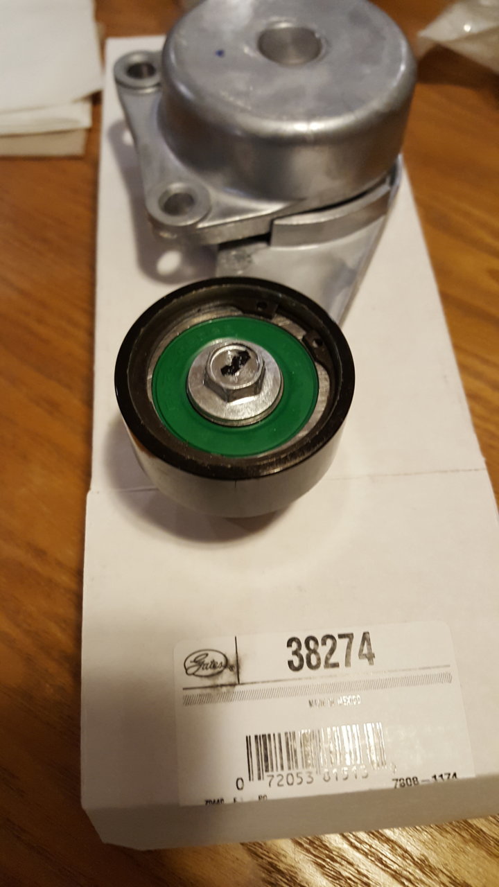

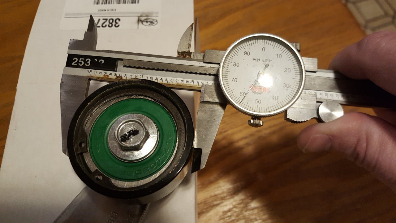

    Quick question if anyone knows or can check, the smooth pulley that comes on the stock dynamic tensioner is that 76mm or almost 3 inches wide. I just got a replacement from magnuson and he said that's the correct size. Problem is I cant get it to clear the crankshaft pulley. I thought if I was reading correctly that the pulley should be close to 50 mm.

    54mm is what it should be, or 2.1".
    A 50mm or 2.0 pulley will work as well.

    ok thanks, they sent me the wrong part.
    @12TRDTacoma is correct, it's a 54mm (~2.15in) pulley for our stock tensioner.
    Here's the replacement Magnuson sent me. They simply replace the original 3 inch pulley on the Gates 38274 with the 54 mm. It's not the first time they've sent replacements with the wrong pulley.
