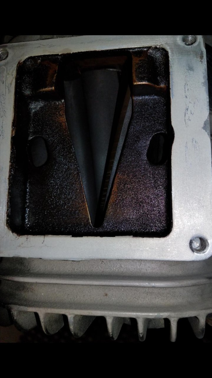

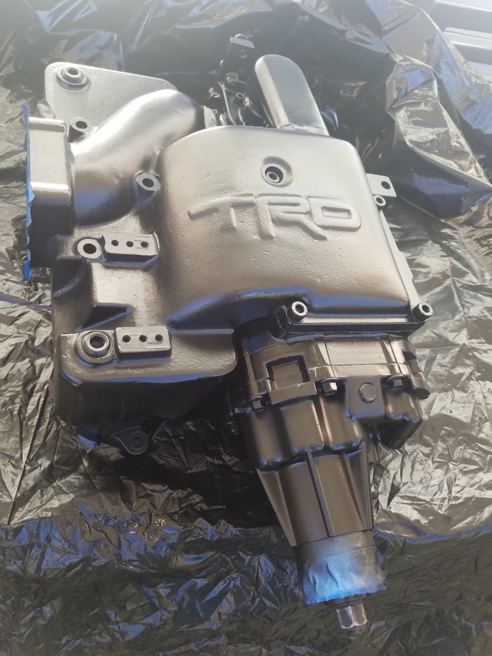

    V6 5sp,RegCab,TVS1320 Supercharger, 56mm pulley, methanol injected Haltech ECU, AC Tvs1320 supercharger,(MUST DO) every 125,000- 150,000 needs rebuild Projector headlights HID 5 speed manual Amsoil for all drive train Smaller 56mm custom pulley, (MUST DO) 2004 DESNO fuel injectors, zero ping ping, 2004 side door mirrors Dick Cepek Rims, Michelin tires LTX, ATM Pathfinders Dynopro ATM ( that last 100,000 miles) Now running Dynopro ATM mud and snow tires KN cold air intake Cat back dual exhaust with ss exhaust tip, Raised exhaust tail pipe to 2" below body line Optima*dry cell battery,red top Alpine sirius radio, 200 watt amp, focal is165 split door pod speakers Focal door speakers Subwoffer behind seat Viper alarm, Electric Locks Dark tinted windows, bucket seats corbeau lg1 Tacoma Rubber floor mats TRD fender extenders, Bilstien shocks, King shocks JBA UCA trailer iv hitch, electric brake control, Drilled slotted brakes, High carbon steel (MUST DO) EBS green stuff 7000 series pads(MUST DO) TRD engine oil cap TRD stick shift, Marlin crawl shift kit. Rear sliding window 2002 4Runner functional hood scoop cut into Tacoma hood, 4Runner dual overhead map light Gentex Auto dim + Compass + Temp, garage,rearview mirror Snow Methonal kit stage 2 Custom 3 core aluminum radiator Linex bed liner Haltech stand alone ECU, Intake supercharger gauge. Stainless steel brake lines, Custom leather wrapped steering wheel, Haltech stand-alone ECU,
    Here is a mod I just did. “PORTING YOUR SUPERCHARGER”
    I just had the inlet and outlet ported on my TRD supercharger with full rebuild and got it back yesterday.
    Excited to see what horse power gains And added boost I get from porting. I’m at 10 pounds now,
    Hopefully I will have a little more boost
    But definitely significantly reduced iat’s for more timing = more power
    Painted the supercharger last night and will install it today.
    Running stage II snow methonal kit
    Running 2” pulley
    Ported supercharger

    Pretty sweet man! How do you establish your meth settings? I'm guessing on mine.

    You probably should run a 2 or 3 number nozzel.
    I have a progress kit that starts to spray at 4 pounds spraying up to 10 pounds, now will adjust it for the new boost from porting.
    An AFR guage will work
    Or do a dyno test to see you print out for where your AFR is.
    Will Depend on if your at sea level or high altitude and boost you have.

    Have progressive, #3, starts at 3lbs, sea level, and dual afr's. No dyno yet. Custom tune soon.

    Unless you changed the gearing, or pulley size, I would think your boost readings would go down a bit? By porting the supercharger, you’re removing restrictions and allowing more flow on the discharge. The reduced restrictions could net you out reduced psi, but also significantly reduced iat’s which would be great.

    Will see, either way, significantly less heat equals more timing equals more power.

    Very cool!! Yeah I remember reading about your truck and how it had a ton of miles on it.
