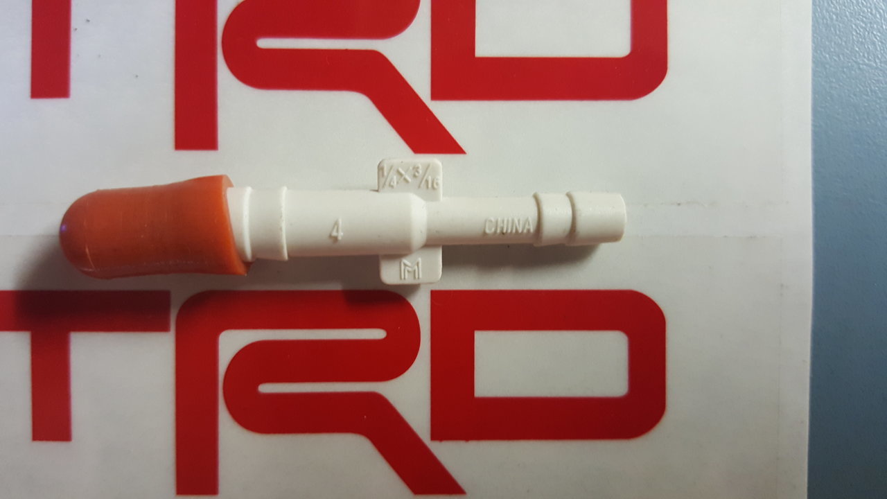

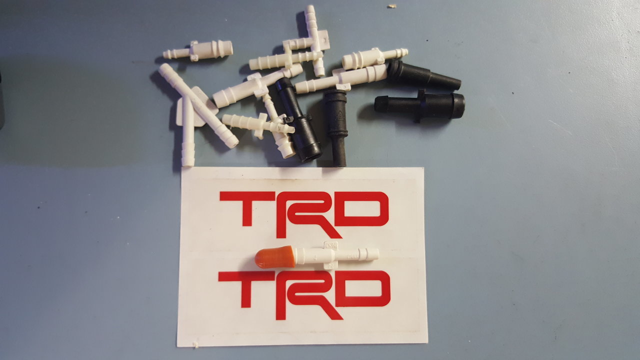

    @fatfurious2
    Assorted reducers ive accumilated over time...
    Notice the orange cap on 1 of em?
    Thats my original boost port cap (factory).... it fits perfect on the 1/4" side of that reducer
    Zoom in on bottom pic, u can see the size imprinted on the reducer
  9. Nov 9, 2017 at 10:16 AM
    #89
    fatfurious2
    Jun 28, 2014
    #132884
    49,917
    David
    Ashburn, VA
    2010 TRD OR Access Cab
    thank you! Now I need to get to Napa

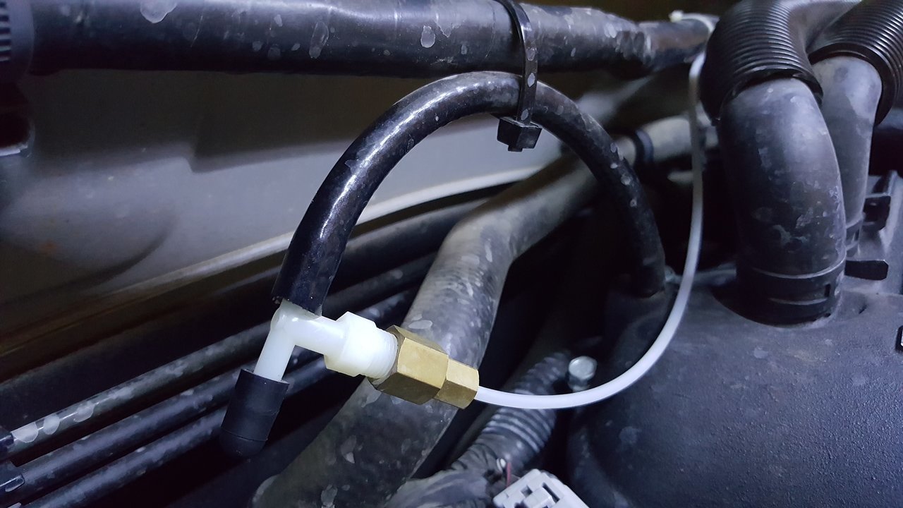

    @fatfurious2
    Or, now that i walked into my cold ass garage, moved truck, popped hood.... heres my connections.....not boost referenced, but the Tee allows me to boost reference in seconds as shown in my video i posted somewhere recently. I just gotta swap a cap and the intake line.
    Now, i cant recall where exactly i got this Tee. I pologize
    Maybe it was a lowes special now that i think of it and compression fitting. I dunno, i had 2 diff boost gauges and a line/compression stock i hoarded over time....crap20171109_101408.jpg

  11. Nov 9, 2017 at 10:19 AM
    #91
    fatfurious2
    Jun 28, 2014
    #132884
    49,917
    David
    Ashburn, VA
    no worries! I got a Tee with the gauge. And I have some hosing from something else. This was my plan, but the hosing that comes with the gauge, and the Tee do not work together. Go figure!
