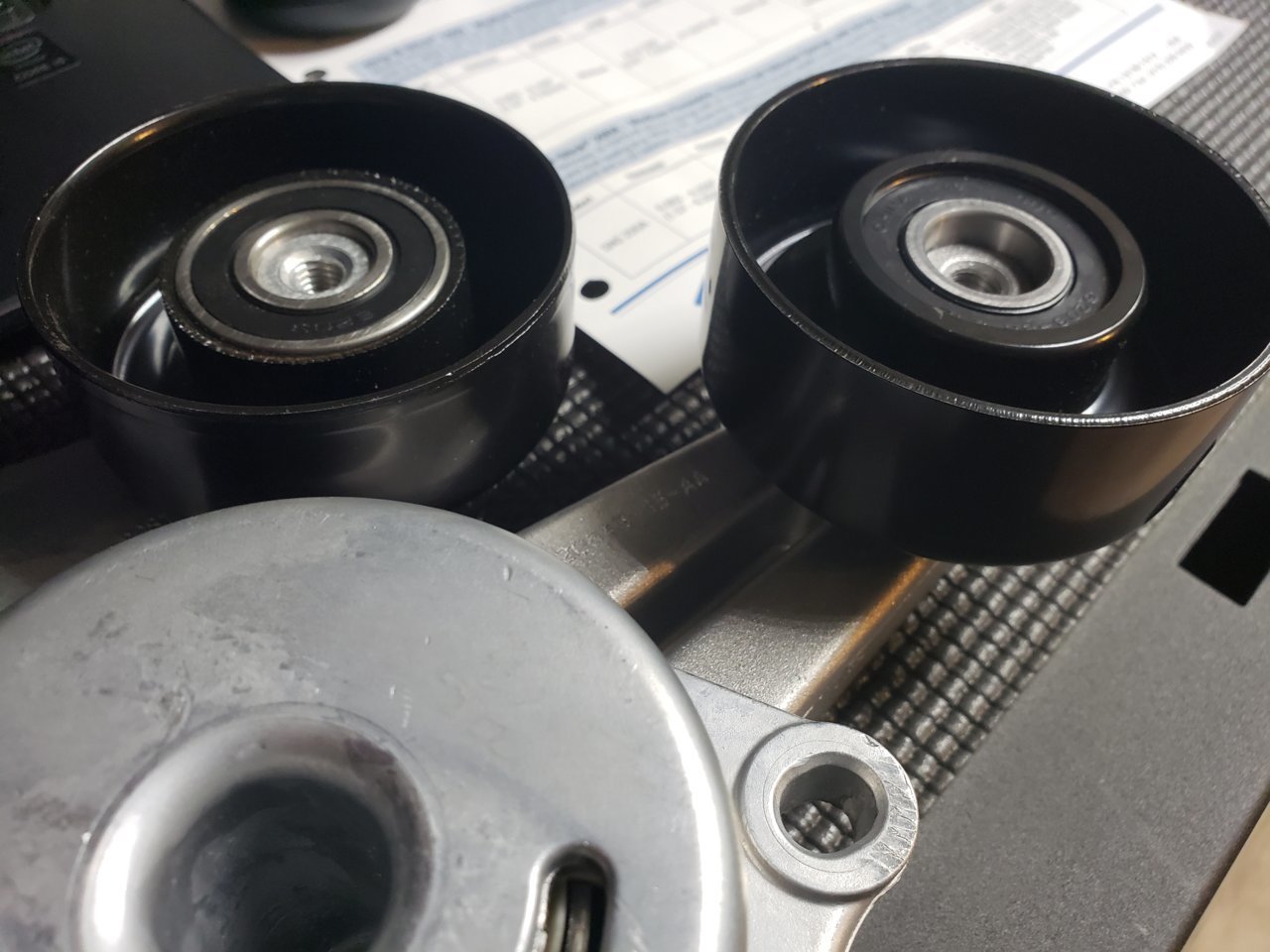

    @JacksonTacoma
    I have a stock unused AC delco tensioner and just received the Roush tensioner today. I dont know what our stock tensioner measures as far as spring rate but the delco measured 50ft lbs and the Roush 80. This was just with a breakaway torque wrench set to break away right when the tensioner reached the stop.
    I did cycle the torque wrench and each tensioner through full range of travel numerous times prior to testing.
    Yes the Roush has a significantly stiffer spring.
    BUT, mine looks the same as yours Jackson as far as the shaft height. I dont like it but I'm sure it would be fine as is because the flanged head bolt keeps the other side of the bearing centered. I will most likely use washers or a shim though to make the effective length of the shaft longer and alleviate some of the load on the bolt.
