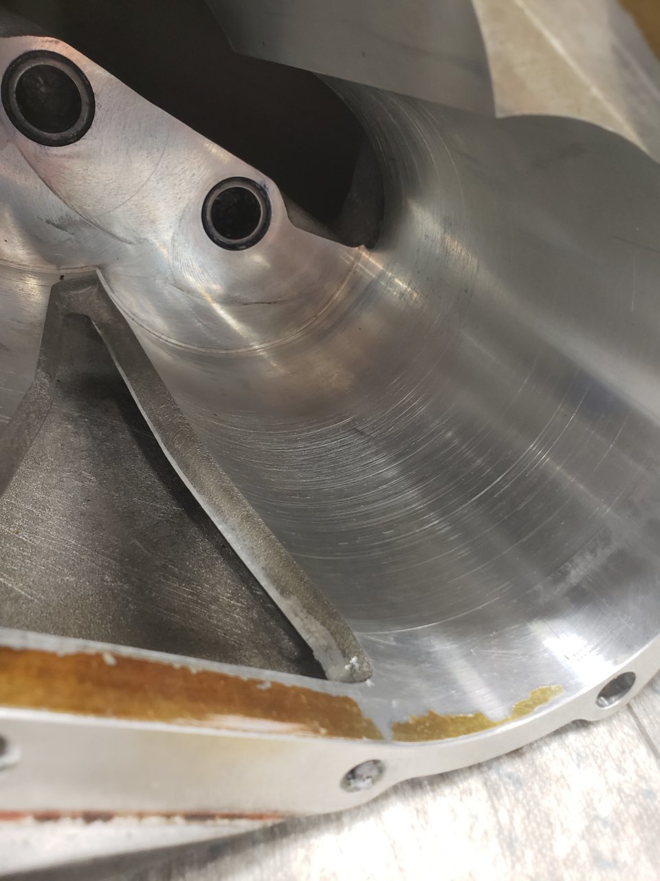

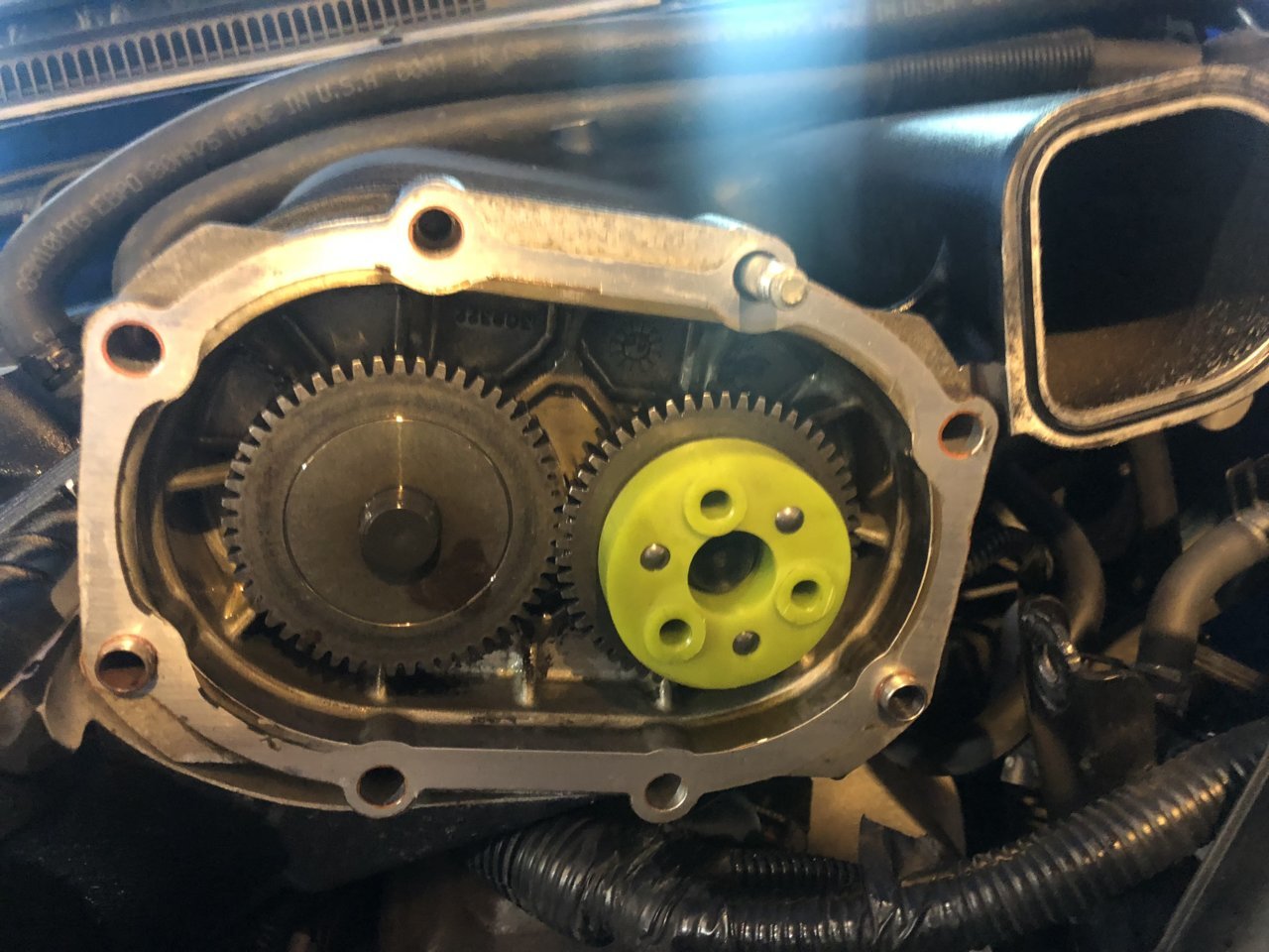

    Quick question. I am putting the supercharger back together. The new coupler has 3 raised holes on each side. Do i put the shafts in the raised holes on each side or the level holes on each side. I am thinking raised. But not sure why.
  14. Dec 1, 2018 at 4:13 PM
    mr.trd
    mr.trd Are you Recreationally Insane?
    Jul 9, 2008
    #7842
    1,447
    Brant
    Pocatello, Idaho
    '06 S/C 1GR-FE DCSB
    Icon coilovers w 14" 700lb springs, Icon billet UCA w/ Delta joints, custom built Icon rear resi-shocks, Icon stage 3 rear leaf pack, Archive Garage Hammer Hangers w/ homemade spreader bar, superbumps up front and timbren bumps in the rear, Crown brake lines, U-bolt flip,4.88's with front ARB locker and ARB dual compressor mounted behind back seat, 285/75R17 BFG A/T KO2's on Bronze Icon Alloy Compression's, 5th gen T4R budget big brake kit, CBI Off-Road Fab. custom Trailmaster 2.0 with swing-away tire carrier, CBI custom tube front bumper, CBI kickout sliders, CBI full flat belly skids including gas tank,CBI Ditch Light brackets w/ Heretic Studio Quattro's, Heretic Studio's 30" Amber on the front, Heretic Studio 40" bar under the Front Runner Roof Rack, Expedition Essentials RAM mount, Leer used shell, OEM black chrome sport headlights, fog lights always on mod, rear locker anytime mod, TRD supercharger, URD Ucon-EMS, Deatschwerks 255 fuel pump w/ URD external fuel filter kit, AFE intake paired to a Safari Snorkel, URD spec-U exhaust w/ factory Tundra muffler behind URD equal length headers.
    Also is this part of the reason for low boost and not the power I feel I should have compared to other suoercharged trucks I have driven. The impellers have contacted the housing. Or I have had sand go through the charger cause the housing has grooves in it.
  15. Dec 1, 2018 at 4:17 PM
    mr.trd
    Jul 9, 2008
    #7842
    1,447
    Brant
    Pocatello, Idaho
    '06 S/C 1GR-FE DCSB
    After looking at the coupler again. Not sure that it matters.
  16. Dec 1, 2018 at 4:32 PM
    mr.trd
    Jul 9, 2008
    #7842
    1,447
    Brant
    Pocatello, Idaho
    '06 S/C 1GR-FE DCSB
    Put the raised hole side onto the shafts since they were beveled. Helped to line them up and get them started.

    Good call. Also, my housing had those grooves like yours does. I had read that this is normal at some point. I can assure you it’s working fine with my 2.0” pulley at 14-16psi, making good power and with minimal belt slip (now - was getting lots before I took steps to fix it)

    Although it will work either way, the proper method to ensure it sits nice and flush is to place the 3-prongs within each side into the raised holes.

    Thanks. Hopefully i had lots of belt slip also as I could only must a whopping 4lbs of boost with the 2.8. Had factory length belt. Noticed when I took it off that it was almost if not sitting on the stop. The idler was a long ways from the fan clutch. New belt and it is much closer to the fan clutch. In fact if I had gotten the Roush tensioner like I wanted it might touch. This belt almost is too short for the 2.8. I got the fleetrunner suggested on the first page. But it fits! But will have to be replaced again if I go 2.6. Might have to buy 2.5, 2.6 and 2.7. See how they all are. We will see later tonight if I picked up and boost.
    Thank you. After you did your maintenance and put the new coupler on did you s/c sound completely different. Mine sounds dry almost. I know i have 4 oz of oil in the nose and the bearing were packed quite well. Used almost the entire tube on the bearings. But it just sounds dry. But no more clatter when I turn it off. Oh and only 2 oz of oil out of it. And tried to put more than the 4 in but just ran out at about 3.75 oz. So started it and let it idle for about 2 minutes and tried to get more in, but it ran out again.

    Pretty sure I was able to get 5 oz or very close back in. And yes it is louder since the old coupler spring is no longer in there to take the shock out of the rotating components. It has a more consistent rattly sound. Which according to others after installing this fixed type of coupler is experiencing as well. I can say mine sounds much better than before that’s all I can say. With a roots a consistent medium tumbling rock sound is actually normal.
