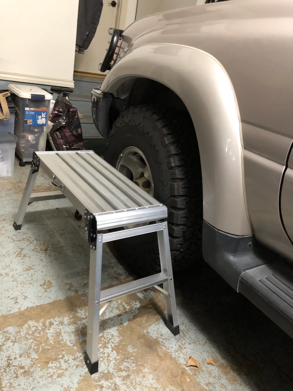

    My latest best acquisition. I’m vertically challenged. $25 at Northern Tool.

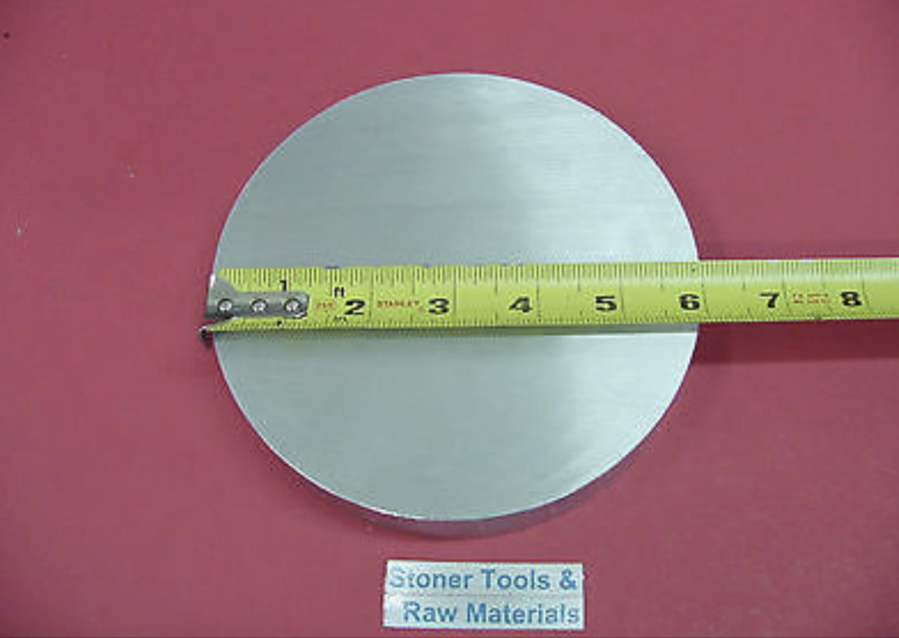

    I found what I’m going to use for the DIY dual fuel pump hanger. 6061 round stock. 6” x 1.25” thick.
    The factory fuel pump (top plate) is just a hair under 6” diameter. If 6” is too big, I’ll mill it down with my router.
