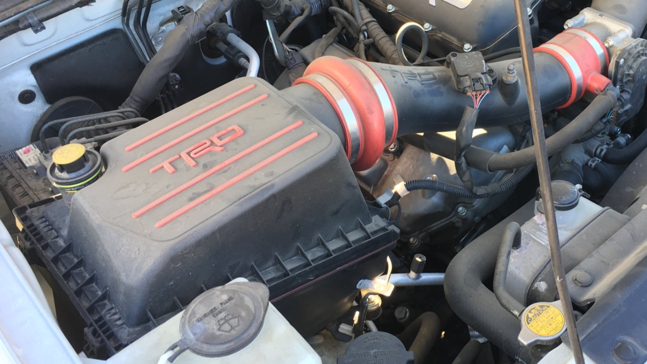

    TRD tune currently with what I believe to be the first gen TRD CAI. This one:
    I had the OV handheld. Was running the 91 octane map. I wanted to trade up to the IOtech setup in order to make my own edits. So, Mat had me flash my truck back the original file (TRD tune) and send the handheld back to him. That's where I'm at now. Waiting for that.

    Did you do a hard PCM reset prior to running the 2.5 pulley? I found the computer doesn't like big step downs in pulley sizes without performing a hard reset on memory prior to running it. It could be as simple as that honestly, because your intake is a solid setup, and that pulley size is tested good on the TRD tune with FPR, however, not all tunes are created equal... so there may be a software AFR variance in yours in comparison to say my setup when I was running my 2.5. Mine still has MAF issues after reverting back tot he URD intake and modifying it with a 45* bend instead of a 90, but I'm pretty sure I know what I need to do to correct it.

    That's the 2nd generation CAI made by K&N IIRC.
    This was the first iteration made be AFE or AEM I don't remember. I don't think it was CARB legal so they scrapped it or something. This one showed actual gains at the dyno whereas the new one does not

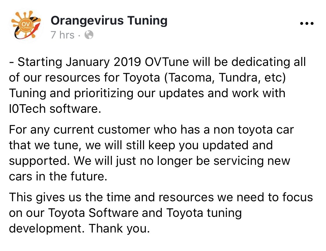

    14 DCSB 4x4
    Hopefully this means 2019 is the year for us 2nd gens getting more tunes.

    When did he post that?

    This morning on fb.
    Also I ordered one of his logging kits. Supposed to be when I get more performance mods so he can dial in the tune again.

    Just let us know. If you have a Gen 2 TRD intake that will most likely your problem right there if the reset doesn't clear it up.
