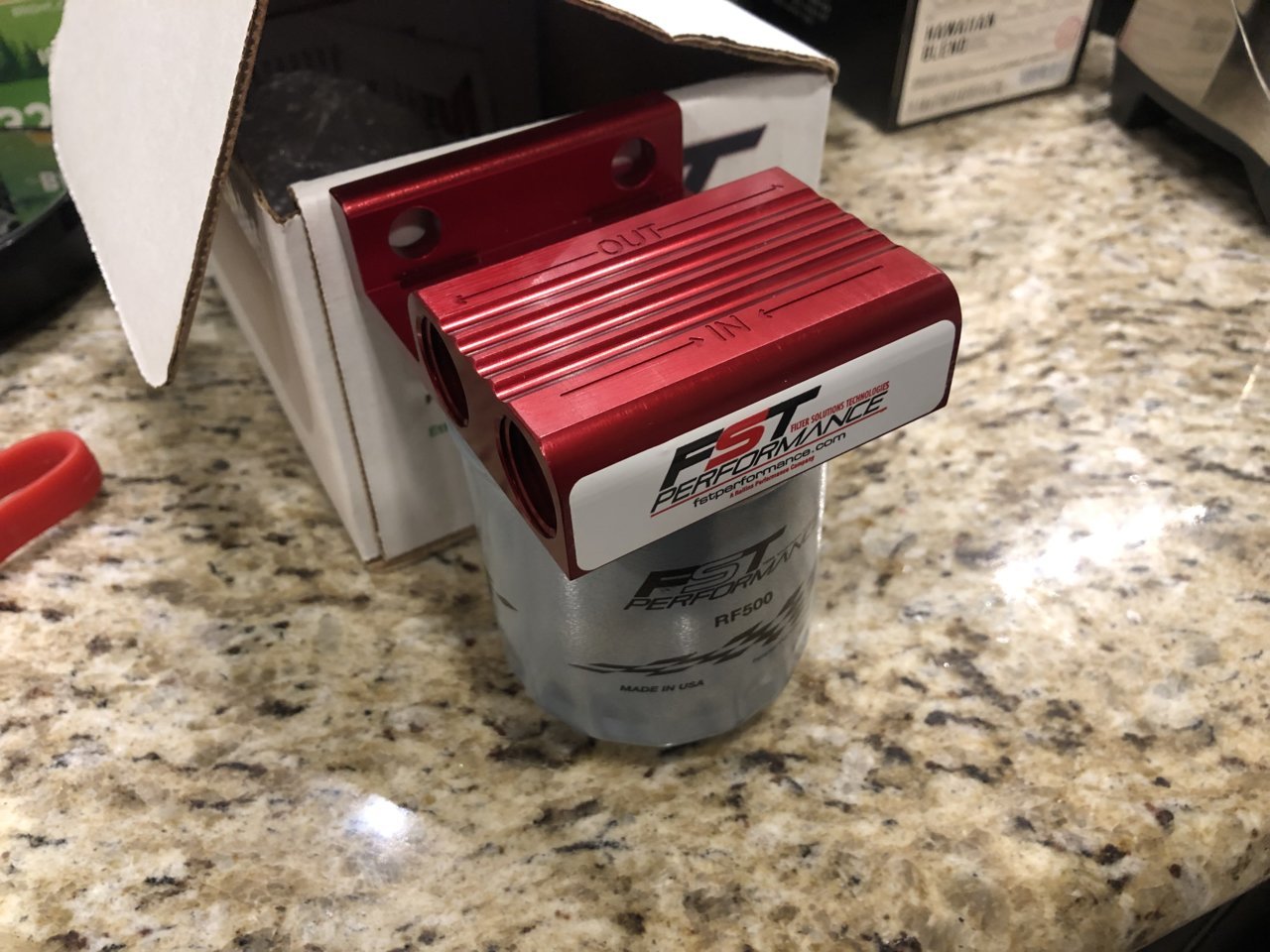

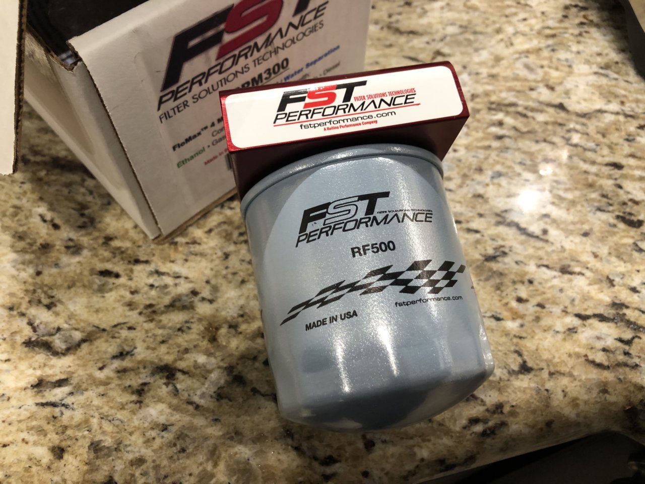

    @Torspd Wanna link your fuel filter setup? I remember you did a while back and it looked pretty in depth, something that looked like an oil filter setup but for fuel.

    You mean this?
    https://www.fstperformance.com/

    Yes? Was looking up how to convert the existing fuel lines to NPT but got bored and stopped lol. Pretty sure I'll just have to cut off the stock fuel fitting on the outlet side (I think?) and just double clamp it with some fuel hose to a NPT fitting.

    These fittings accomplish that without cutting.
    Male:
    640930 -6an male to 5/16” male
    https://www.amazon.com/dp/B003CGSUL0
    Female:
    640863 -6an male to 5/16” female
    https://www.amazon.com/dp/B001P29076

    I just noticed you said NPT. Those fittings are -AN. But there are -AN to NPT adapters you could use if you truly need NPT.
