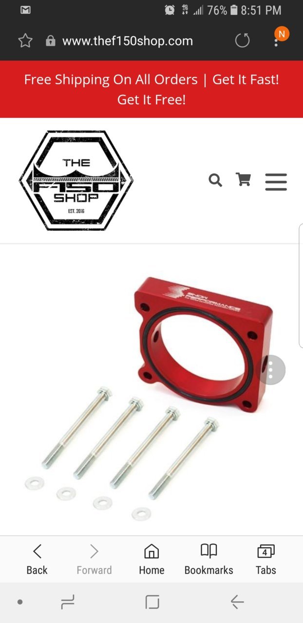

    In a later post he said tap into it for meth nozzles.
    Roostfactor[QUOTED] likes this.

    Are they npt tapered? Make sure you have the correct tapered tap.
    Drill small straight pilot hole first then step up to drill bit size smaller than tap. Drill press is best. Use cutting fluid when tapping and drilling. For tapered use a tapered tap and test fit the fitting every so often to make sure you don't tap too deep or bottom the fitting out.

    Keep in mind you will have to have a solenoid or check valve of some sort to prevent engine vacuum from sucking the meth through the nozzle.

    Never thought about that. That must be something kits provide isn't it? Or is it required due to the proximity to the throttle body if using the adapter like @White lightning boosted is thinking?

    Making something like this fit behind the tb for an injection location.

    Good catch @Roostfactor, they have one way valves and solenoids for this.
