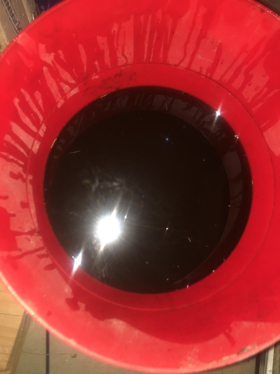

    WS fluid. Looks nice. Mine looked about the same at 60K miles until I did a flush. 20K later and it was warmish looking again. I'm confident the decrease in clutch slippage will now allow the fluid to remain cleaner.
    Go Valvoline Max life. It's way better than Toyota's WS garbage.
    That would be I.
    jojotoo and GT7[QUOTED] like this.
