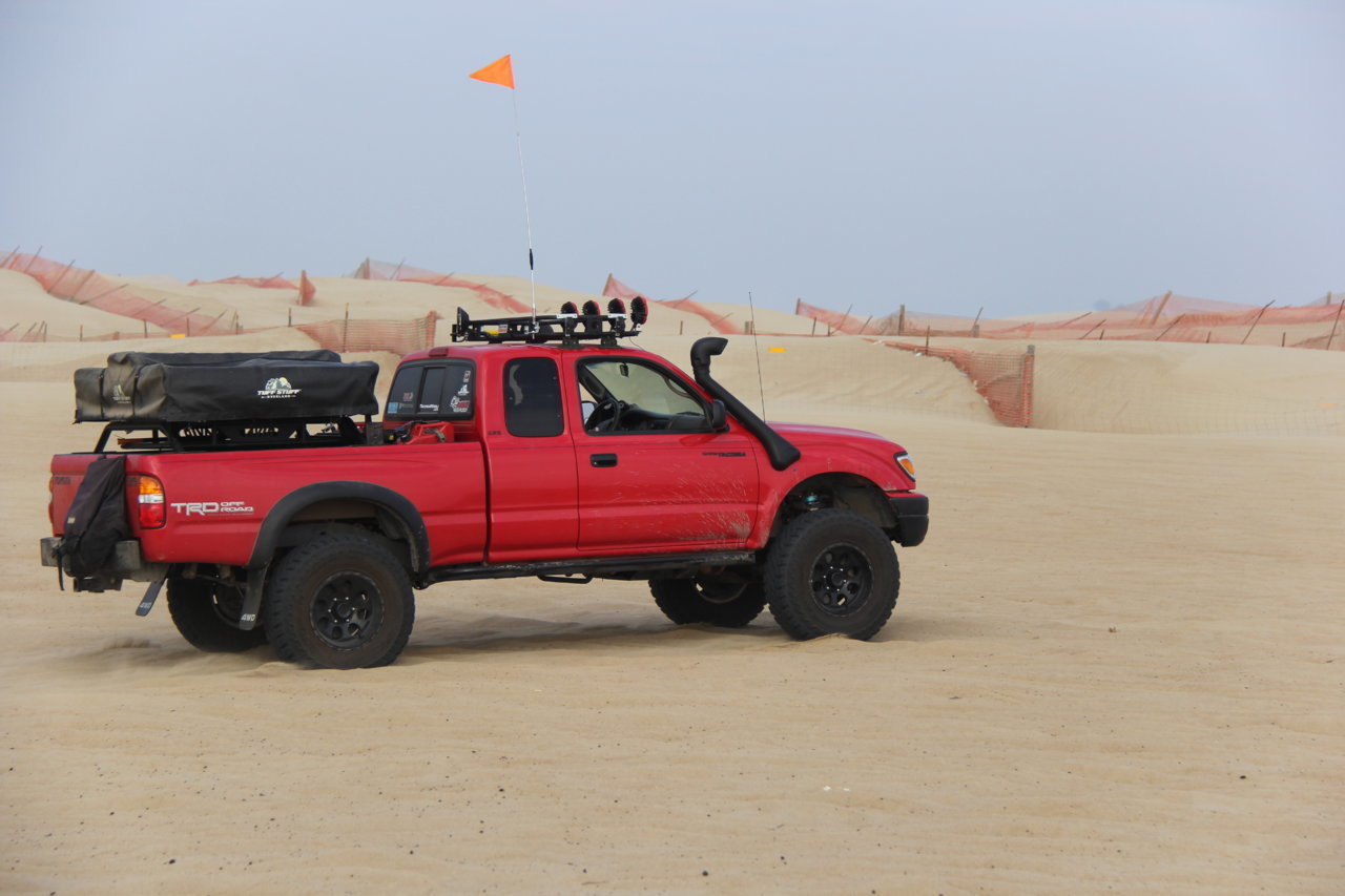

    I posted in here awhile back asking about how snorkels work with the supercharger, as I purchased one of the Safari knockoff 1st gen snorkels on eBay (for $98, great deal...virtually identical to the ARB)
    Anyhow, been running it for about a month now and it's 'effing awesome...no complaints at all. Haven't noticed any ill effects on the way the supercharger runs or performs, if anything it might be a tad healthier (cooler air from outside the wheel well I suppose). Was worried about air restriction but that doesn't seem to be an issue

    Very nice. I saw dobinson’s new snorkel for the 2nd gen and am having a hard time resisting it. With no wheel well liners I have no choice really.

    I'd say that proves what I've always believed, you can buy knockoff stuff on eBay if you're smart about it!

    Most of us were skeptical when we saw it pop up on eBay at first, but a member on here bought both (the ARB and the eBay knockoff) and did a side-by-side comparison and they were virtually identical, and hugged the lines of the truck the same way. Normally I'd want to support a company like ARB with the reputation and quality they have, but at $400+ for some plastic and tubing versus $98...I couldn't justify that price difference lol.

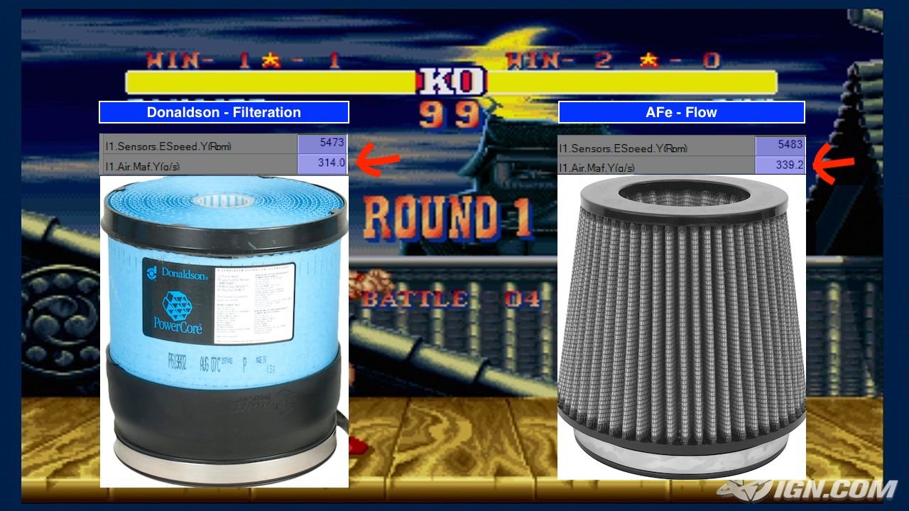

    I woke up at 4am and couldn't go back to sleep. So why not tinker with the truck a little, right? I've been considering switching back to the AFe Pro Dry air filter from the Volant/Donaldson Power Core. No traffic at 4am, so I decided it was a good opportunity to do some WOT datalogs to see what the differences were (if any) between the two filters. I did 3 runs with the Volant/Donaldson and 3 runs and took the best of both filters.
    The AFe filter flowed 25 g/s more than the Volant/Donaldson. I'm sure the Volant/Donaldson probably filters out more particles or whatever. This isn't about that. For those of you who use your trucks in very dusty environments, you'll probably be better off going with the Volant/Donaldson Power Core.
    47*
    97% humidity
    Volant/Donaldson Power Core = 314 g/s
    AFe Pro Dry S =339 g/s
    339 g/s - 314 g/s = 25 g/s
    If the (MAF x 1.18 = Flywheel HP) calculation is to be believed, then 25 g/s x 1.18 = ~29.5 HP.
    I did not reset the battery. I only drove 2 miles with the AFe installed before the WOT run, so the UCON has not had any real opportunity to adjust to the increased flow potential. IF there is some difference to be obtained from the UCON learning, then I could see it being a hair better after a couple days of driving. (IF)
    I imagine there is more benefit to the increased flow other than just flow improvement. The supercharger doesn't have to work as hard to shove air into the engine. It can't push more air than it can obtain. The supercharger belt doesn't have to grip as hard. So in theory, less potential belt slip.
    Yes, in the pic it says “filteration”.

    That is actually why I stayed away from the Powercore. While filtration is important, if a company claims and states that it has fantastic near 100% filtration over X filter company the drawback and compromise to that filtration will ALWAYS be flow. You simply cannot have both high flow and high filtration rates at the same time.
    Your test only further solidified that.

    Good to see it finally tested! For me I will keep running the donaldson, the tiny performance hit is just something I will have to take. After seeing how many particulates get past my afe dry filter I don’t trust it.
    Also curious when you slapped the afe in had you recently cleaned it or did it have some particulates in it?
    I would like to see the difference between the afe proguard filter, and say the pro dry filter with a prefilter on it. Would be interesting to see the differences. Afe claims their proguard filters more than all their other filters but it needs to be oiled. I think it would be fine as long as you dont put too much oil.

    The Volant is a good filter. The intent wasn’t to try and sway anyone one way or another. Just data points.
    The filter I put on wasn’t cleaned or anything. It probably had maybe 10k miles on it. I thought I had thrown it away but recently found it and decided to test it. An estimated 30 peak horsepower is enough for the AFe filter win the spot in my engine bay. Pretty significant. I don’t routinely drive in super dusty conditions, so I think it’ll be fine for my use case.

    Sounds about right. What were the ambient conditions? Temperature and humidity.
